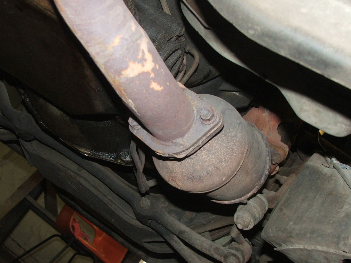

OK guys, time for my stupid question of the week...
Was over working on the Torino this morning and the task of the day was to drop the exhaust out from under it. Got her all up on the jack stands and roll under her with tools in hand to remove the nuts holding the exhaust H pipe to the converters ('76 460). The 1/2" socket was too small, so I put the 9/16" socket on the ratchet extension and got ready to put my all into it to break it loose only to have the socket slip on the nut. Thought perhaps it might have been a metric nut but no suck luck. So my question is:
Is the nut holding the H pipe to the converters 17/32" or have they eroded?
Thanks for your help!!

I wouldn't know the nut size, but the threads may have exhaust cement on them too, along with rusted on ??
Might need to use one of the reciprocating saws mentioned here in another thread

I believe the nuts to be 5/8 originally.make sure your using a 6 point socket.nuts are probably rusted away,try a metric socket that fits snuggly,you might have to tap the socket onto the nut.heating the nuts will  help greatly and or soaking them in weasle piss(penetrant oil).

Got 'em soakin! 99% sure it was a 9/16 nut I was using but I'll bet you are right that it was a 12 point. I'll have to check and get the appropriate style. They aren't too rusty but like kenneth suggested might have something on them to prevent loosening.....

I think they've probably rusted away a bit and now they're "between" sizes. I try to always use 6 point sockets, especially on something that's rusty or hard to get started. If you can give them a "whack" with a hammer and cold chisel it might help break them loose too. If all else fails, a nut splitter has helped me on occasion.
