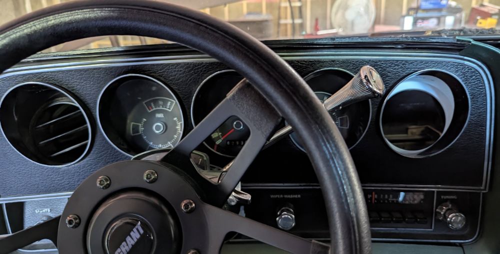

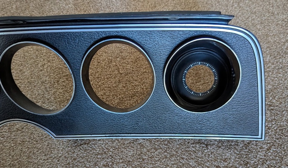

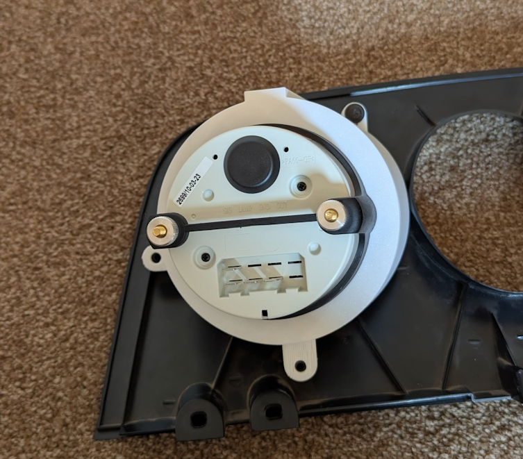

Howdy everyone!
Some of the friends half my age have started to muck around with these fancy 3d printers out there, and it's got me thinking about potential Torino applications.  Has anyone come across a print for the late model Torinos to replace the clock dummy plate with something that could hold a gauge?
I may be explaining the part wrong, so I've snapped a few pics of what i'm talking about.  I'd cut a hole in mine years ago, but you'll get the gist.
If nobody has come across such a think I may try my hand at modeling this to fit an Autometer Z series tach as the font looks quite similar to the stock tTorino gauges, so it might look right at home.

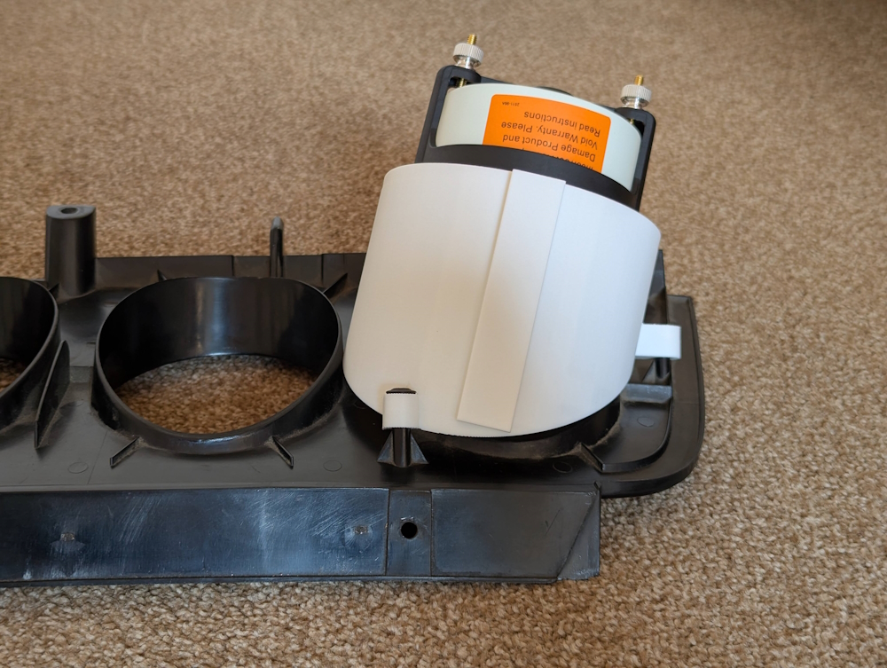

I was thinking of something more like this that would replace the existing part and the gauge could mount into:
First test print is off by a bit, but I'm sure with enough tries I'll be able to get something workable.

Model #2 is more round, tweaked the size of the opening to hopefully be right this time, and adjusted the one tab I got wrong last time.
Should know in a day or two when I get the print back if I'm on the right track.

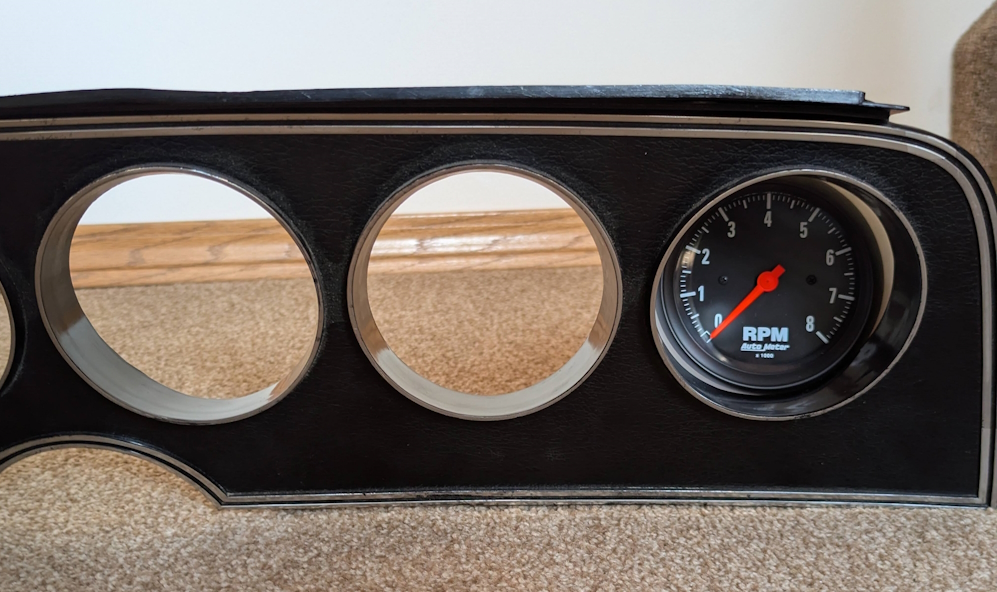

nice, what diameter opening and how much clearance for the OD ring?
The measurements are all in mm as I'm using Tinkercad (it's free), so everything needs to be converted.
Outer diameter = 115mm = 4.528"
Inner diameter = 105mm = 4.134"
Gauge mount hole = 88mm = 3.465"
Autometer lists their Z series gauge bezel as being 3 13/16" or 96.8375mm so should clear the bezel by 4mm each side.
The gauge opening is 3 3/8" or 85.725mm so I could likely go a touch smaller on the gauge hole, but I'll try a test fit for bezel depth before I futz with that measurement.
I have one mounting tab still off by a few mm, so I'll need to tweak and reprint at least once more before I can test mount the gauge in the pod and the pod in the dash.

Print #3 turned out pretty good, but still 1mm or so off on the mounting tabs.  I had angled this one 15 degrees so it should point towards the driver, and that should help show the whole gauge similar to like Inkara1 has done.
I should get out at my shop (a few hours away) by the end of the month to test fit in the dash with the tach mounted before I make a fourth version.  I've got a sneaking suspicion there may be a bracket in the way, as projects aren't really projects without a few speed bumps. Smile

Post Options Post Options   Thanks (3) Thanks(3)   Quote Dubz Quote  Post ReplyReply Direct Link To This Post Posted: 25-May-2025 at 11:17AM

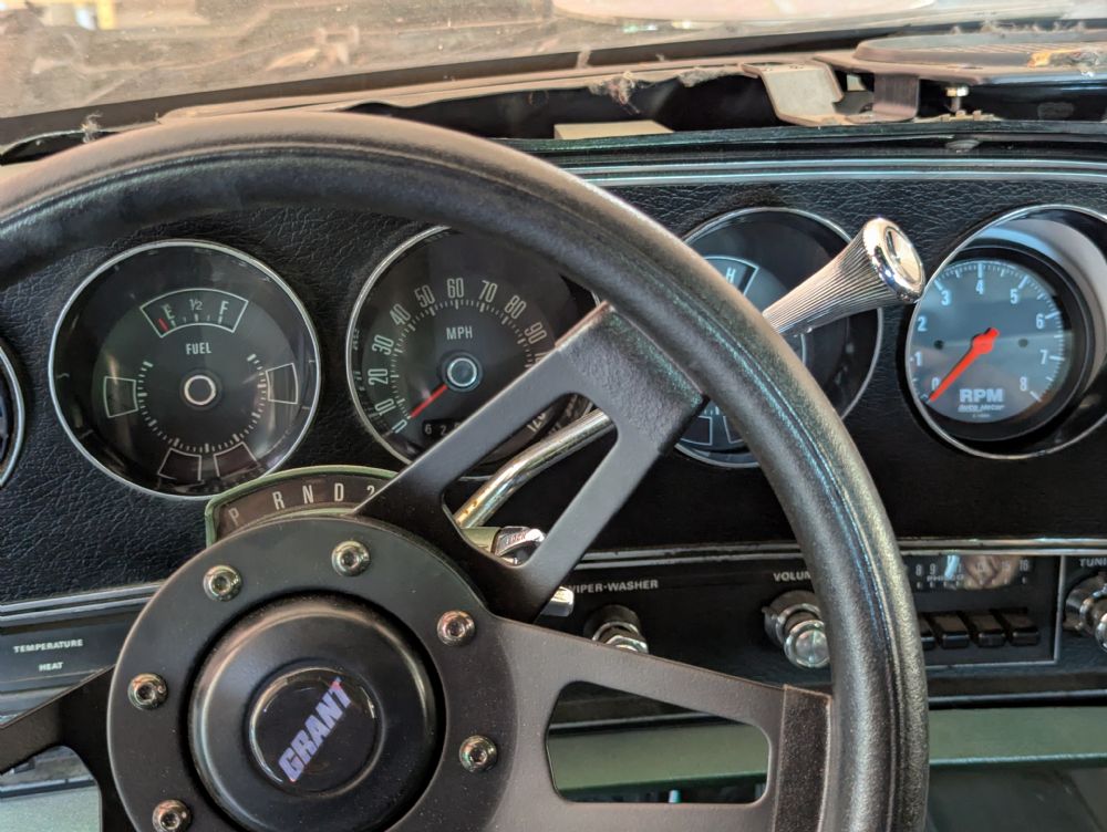

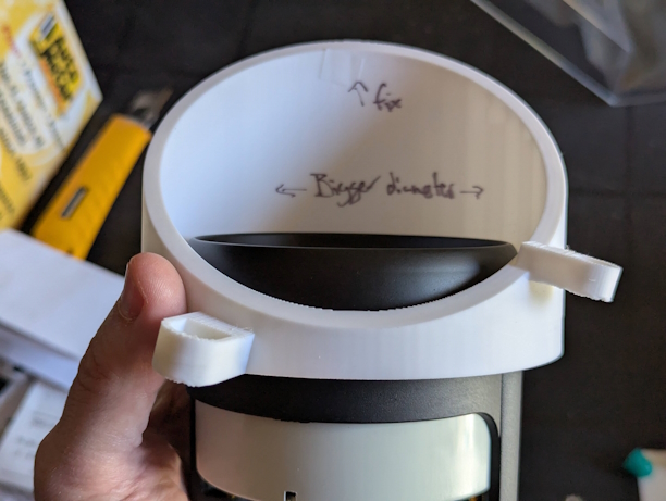

Dimensions of model #3 are close but not quite there yet.
The gauge fits nice and snugly in the mounting hole, I nailed that measurement from the spec sheet :)
Now that I have the gauge, I see it's bezel is taller than expected, so I'll need to make a new print that is deeper, so the pod can still screw onto the dash panel without having to cut apart anything in the original panel.
The angle looks good from the driving position at 15 degrees.  There is indeed a bracket further back in the dash that may be close, so I'll make the new version 12 degrees instead to hopefully clear it.  Hopefully doesn't make a huge difference to the viewing angle.
Stay tuned for more updates.

Print 4 is a success for lining up all the holes!  Won't be back out for a test fit in the car for another few weeks, but it's looking like this should be pretty darn close. Cool
