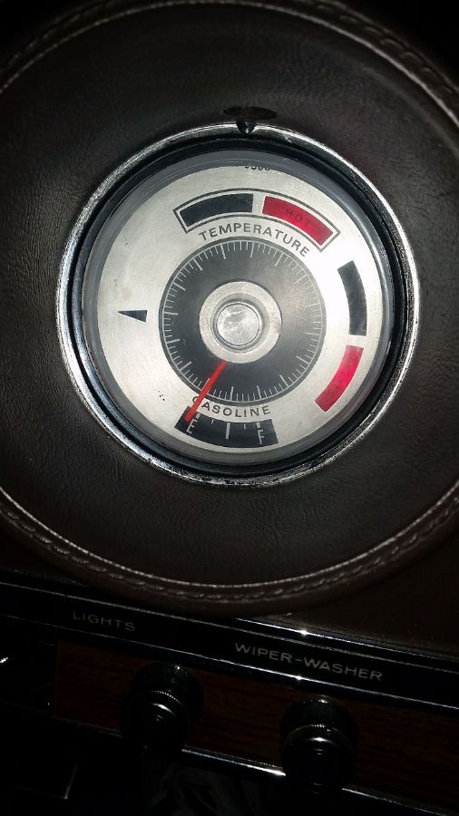

What lights should be illuminated when I key-on, but don't crank yet?
Right now I have two that light:  a) set belts, b) oil.
Seems like c) temp should also be on, d) charge, e) brake?
Can someone advise what they see key-on, thanks!

Post Options Post Options   Thanks (0) Thanks(0)   Quote californiajohnny Quote  Post ReplyReply Direct Link To This Post Posted: 20-December-2019 at 4:16PM
not sure on those years but charge should be on i'd think?, temp may not light until it gets too hot???
 but oil and charge should be...
 e-brake probably not unless the e-brake is depressed some....

Post Options Post Options   Thanks (0) Thanks(0)   Quote gpd294 Quote  Post ReplyReply Direct Link To This Post Posted: 20-December-2019 at 4:46PM
i want to say my wagon's lights originally lit up as OIL and ALT and that was it, because the SEATBELT light wasn't connected.
Hope this helps.
Post Options Post Options   Thanks (0) Thanks(0)   Quote schufitz Quote  Post ReplyReply Direct Link To This Post Posted: 21-December-2019 at 9:36AM
Del...the 'belts' light comes on at first, but goes off after maybe 10 seconds.  The 'Alternator' and 'Oil Pressure' lights should remain on.  A few times a season mine acts funny and the 'Hot' and 'Brakes' light come one once started.  I lose the radio, turn signals and fuel gauge reading drops to E
when this happens.  A little wiggle on the key seems to remedy the problem.  These ignition switches are know to get a bit loose after 50 years.  I hope to get a new one ordered and put in before next driving season.

Post Options Post Options   Thanks (0) Thanks(0)   Quote Del Griffith Quote  Post ReplyReply Direct Link To This Post Posted: 21-December-2019 at 1:37PM
Hi, since my post I have seen ALT & TEMP come on a few times, so I will investigate the switch connector.

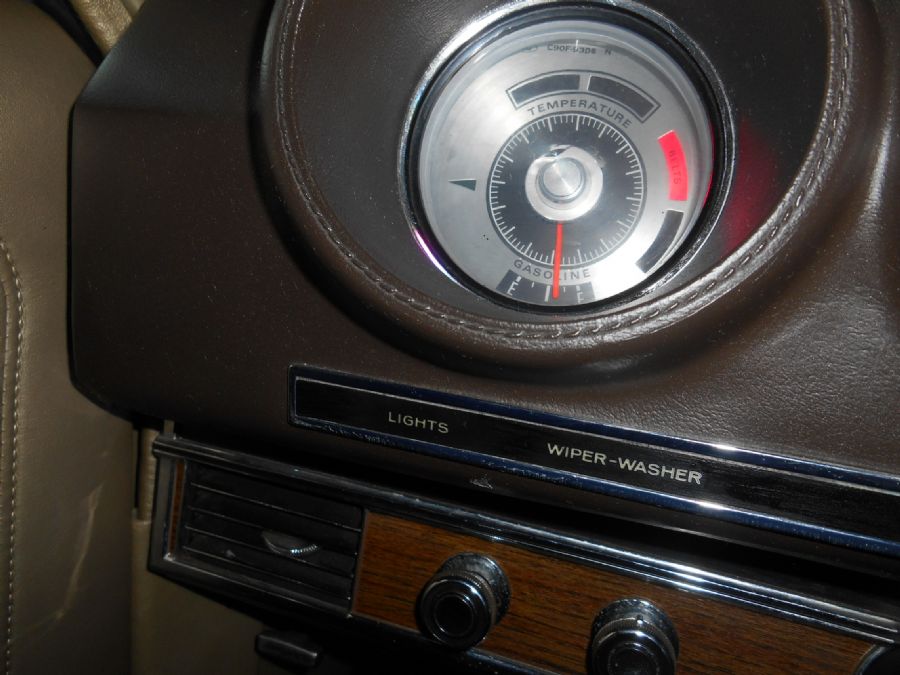

Post Options Post Options   Thanks (0) Thanks(0)   Quote Del Griffith Quote  Post ReplyReply Direct Link To This Post Posted: 02-January-2020 at 4:30AM
Cleaning ign. switch got all lights illumination for a start, however once engine is running setting the e-brake one doesn't also light the brake indicator.
Seems like it should, yes?
Any guesses as to cause and switch location (down near e-brake pedal)?

Post Options Post Options   Thanks (0) Thanks(0)   Quote californiajohnny Quote  Post ReplyReply Direct Link To This Post Posted: 02-January-2020 at 3:51PM
look at the e-brake pedal if there's no switch there then it just a brake warning if one half of the system fails that would be on the prop valve if both front and rear systems are working then that light won't light up Wink

Post Options Post Options   Thanks (0) Thanks(0)   Quote Del Griffith Quote  Post ReplyReply Direct Link To This Post Posted: 04-January-2020 at 12:25PM
Thanks CJ
No pedal switch so it must be prop valve driven and only lights when one side is off.
'69 Torino 2 -Door Coupe
Post Options Post Options   Thanks (0) Thanks(0)   Quote californiajohnny Quote  Post ReplyReply Direct Link To This Post Posted: 04-January-2020 at 1:09PM
that's what i'm thinking! the later cars 72+ are that way if they had a switch on the e-brake it illuminated a different light
