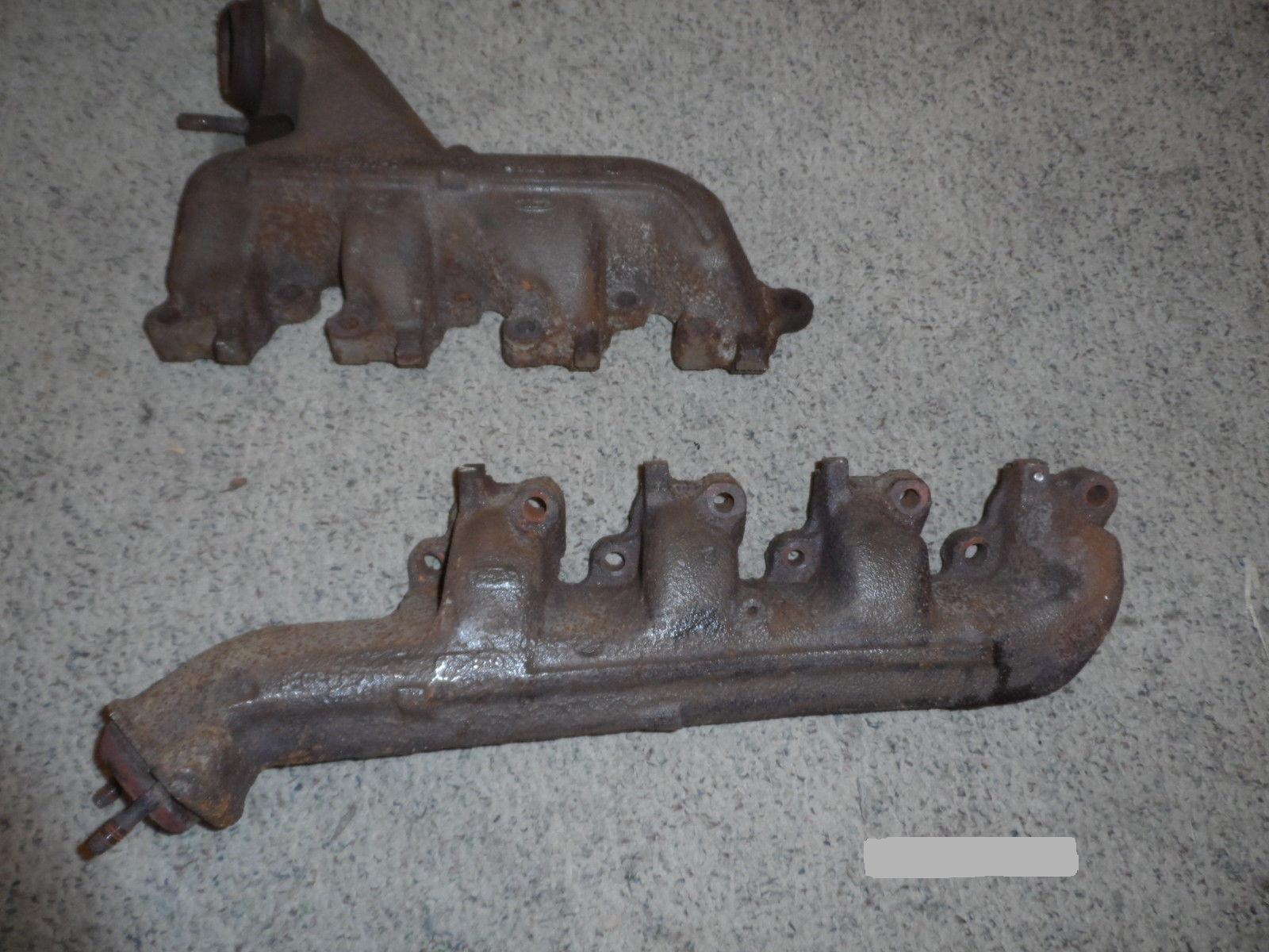

Post Options Post Options   Thanks (0) Thanks(0)   Quote dave302 Quote  Post ReplyReply Direct Link To This Post Posted: 16-March-2014 at 9:53PM
Here is a picture of the DOAE 9431 G and DOAE 9430 G exhaust manifolds.

dave302 View Drop Down
Joined: 08-October-2009
Location: usa
Points: 3171
Post Options Post Options   Thanks (0) Thanks(0)   Quote dave302 Quote  Post ReplyReply Direct Link To This Post Posted: 17-March-2014 at 12:01AM
Your welcome,
The DOAE 9430 G right side (passenger side) exhaust manifold, will fit your engine inside your 1974 torino.
The DOAE 9431 G left side (driver side) exhaust manifold will fit onto your engine perfectly, but I have just learned that the DOAE 9431 G left side (driver side) exhaust manifold will not fit into your torino, because it will touch the power steering box/gear. But i have never seen a DOAE 9431 O exhaust manifold, maybe it will be different?
You will have to find the correct part number for the drivers side exhaust manifold that will fit your 1974 torino. Here is a link of a person who had this same problem with the drivers side exhaust manifold.
Edited by dave302 - 17-March-2014 at 12:08AM
Location: usa
Points: 3171
Post Options Post Options   Thanks (0) Thanks(0)   Quote dave302 Quote  Post ReplyReply Direct Link To This Post Posted: 17-March-2014 at 1:22AM
The drivers side exhaust manifold that you need has the part number is D1ZE-9431-BA with the 2 inch exhaust exit port.
But this same part number (D1ZE-9431-BA) was also used on the driver side exhaust manifold on the 1971 Boss 351 cleveland 4V engine also, and the boss exhaust manifold has a 2-1/4 inch exhaust exit port.
You will have to find out more information from other people, to see if you can use the driver side boss 351 exhaust manifold on your engine. It will fit on your and engine and it will fit into your car, but it does have the larger exhaust port.
The Boss 351 D1ZE-9431-BA manifold with the 2-1/4 inch exhaust ports, will probably be much higher priced and harder to find anyway. So the D1ZE-9431-BA exhaust manifold that you will find for sale (for a reasonable price) will probably have a 2 inch exhaust port.
Here are three pictures of a D1ZE-9431-BA exhaust manifold, but i am not sure if this one has the 2 inch or 2-1/4 inch exhaust port.

You can find the DOAE-9430-G passenger side exhaust manifold and the D1ZE-9431-BA drivers side exhaust manifold (with the 2 inch exhaust port) from any:
1972-1974 torino, gran torino, montego or ranchero
1971-1973 mustang
1971-1974 cougar
That came with a 351 4V cobra jet Q code cleveland engine.
Edited by dave302 - 17-March-2014 at 3:53AM

the D0 manifold, as stated, will NOT fit.  it is for 1970 Mustang/Cougar and 1970/1971 Torino/Montego
1971-1973 mustang
1971-1974 cougar
Thanks for those accurate informations, you save me much time, having fit the wrong manifold.
Would you have an idea where to find the good parts?
