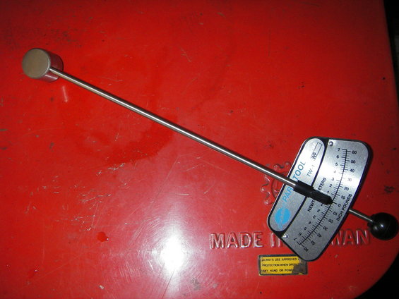

Post Options Post Options   Thanks (0) Thanks(0)   Quote Rockatansky Quote  Post ReplyReply Direct Link To This Post Posted: 23-February-2014 at 2:29PM
Without pulling the pumpkin, I don't know how to get preload right
the guys that do it all day every day use their big honkin 1/2" impact on the pinion nut & lightly feel the preload as the hammer pounds away on it. gotta figure an existing assy with miles on it can stand another couple thou of crush to get back to specified preload?
I used this beauty to set up my manual steering box, an inch/pound beam style from an online bicycle outfit. but then you'd have to pull the pinion bearing housing out of the carrier to get a reading on just the pinion bearings
