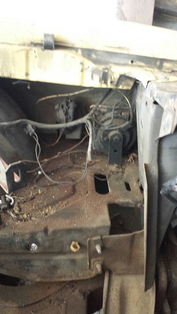

I remember someone asking about the locations of the dual note horns. Right before the new owner arrived to get my yellow '72, I snapped this shot of the factory location on the left inner fender.
Hope this helps someone.
Post Options Post Options   Thanks (0) Thanks(0)   Quote 72FordGTS Quote  Post ReplyReply Direct Link To This Post Posted: 04-March-2014 at 11:05AM
Thanks Joe! I wasn't the one who asked for it, but that photo is helpful for me.

bringing up an old thread.....so I removed my washer tank the other day to see if I had any horns...and there wasn't any. Does the harness piggy back/run along off the washer pump harness loom? I have no wires other than the washer pump harness....Cry
