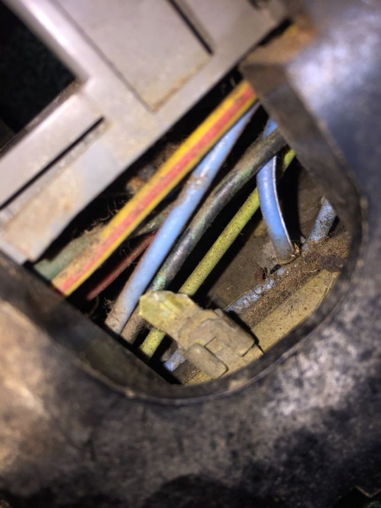

I have more info.  I have power to the turn signal switch as long as I have my meter on the body directly.  If I put it on the ground wire at the switch, nothing, which tells me I have a bad ground somewhere.  The question I have is where exactly is it grounded at?

The strange thing is this:  all the lights work if I turn the light switch on.  So I know the ground for the lights themselves are good, and all the lights are good.  It looks like a bad ground under the dash or at the fuse block, as I have multiple circuits doing the same kinda thing.  And when I checked at the turn signal switch, using my meter, i had power at the connector if i put my ground lead on the body itself.  If i used the ground wire on the connector, nothing.  Again, leading me to think theres a bad ground under the dash or at the fuse block.
Post Options Post Options   Thanks (0) Thanks(0)   Quote 72 RS 351 Quote  Post ReplyReply Direct Link To This Post Posted: 19-January-2026 at 4:30AM
Ford placed main grounds in various places in the vehicles. Common points are the two kick panels, the radiator support, the dash frame, and a couple in the trunk. I'm sorry, I'm not familiar with the older Fords anymore.
Newer Fords have those main ground points using a green headed 8mm bolt, easy to spot in newer Fords. But regardless, there are typical ground bolts placed in the chassis in a few places. Look around and find those, there may be corrosion on them or they've been loosened to add to them, and the connections aren't good.
