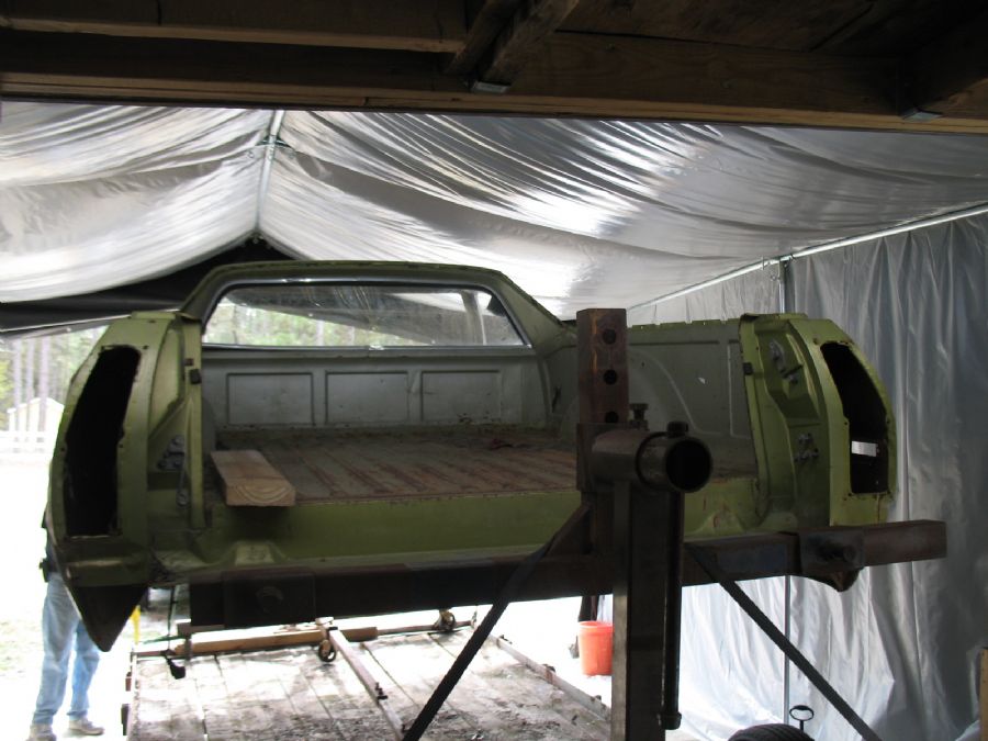

here is my 1972 ford Ranchero Squire started on it about 2 months ago used 1 of the C-2 Fabrication Panels ,now making the rest out of 18 gauge sheet metal .

that I will, I will start a project thread, anyway, the first pan was from C-2 fabrication , took a few hour with air hammer to get it in shape to fit,
I used 16 gauge metal to fix on both sides of the toque box i
 just wanted to show the C-2 panel /ANDY

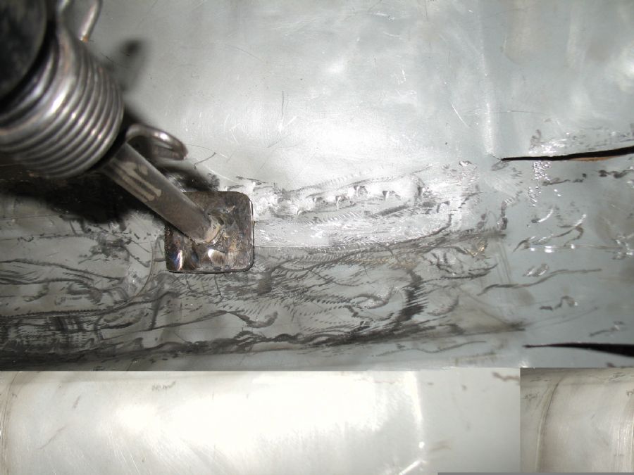

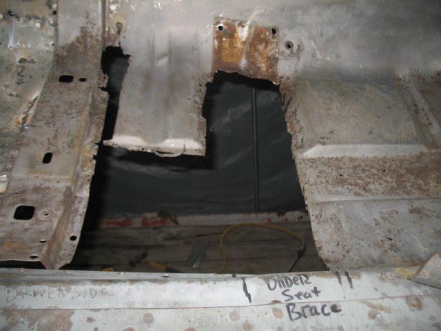

if you look at the second picture thats a store bought pan ,
 they are flat with little profile-
if you look at the old piece in the picture with hole in it they even have the profile backwards,
short of 80.00 with shipping for 1 pan ,
 i bought 4 foot x 4 foot of 18 gauge metal for 40.00
