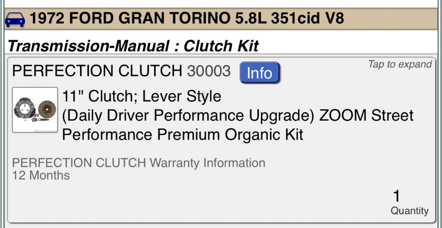

So after reading on questions on flywheels, and looking for a flywheel for Bruiser, a few things come to mind.
First:
Rockauto is not listing the correct clutch flywheel kits anymore for the 72-74 four speed cars.
Data shows a 10.5" wheich is not correct.
AMS used to supply 11" kits and they are no longer listed on Rockauto.
I don't ever recall the torinos using anything but an 11" clutch kit.
Now all the sudden the listings have updated for the correct 11" kits?
https://www.rockauto.com/en/catalog/ford,1972,gran+torino,5.8l+351cid+v8,1129003,transmission-manual,clutch+kit,1993
Note, this is for the 351 Cleveland Q code which I am searching. For all I know they are referencing the H code 351C 2v or 351W 2V.

Post Options Post Options   Thanks (1) Thanks(1)   Quote Yellosn Quote  Post ReplyReply Direct Link To This Post Posted: 21-September-2022 at 4:11PM
This is the clutch I put on mine last year. Nothing fancy, but it seemed to be a decent quality. Works well so far.
Weird about the flywheel listings??🧐
