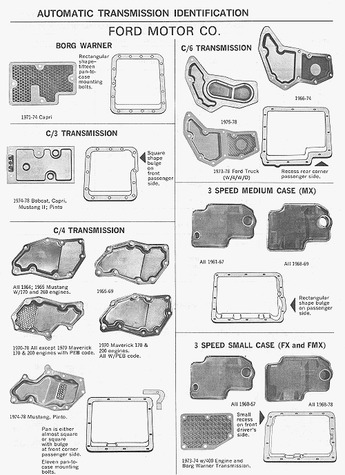

See the image below to help ID your Ford Transmission.

just for giggles check to see if the door data tag decodes to match the transmission that you find under the car

Mine didn't even have the door tag! I had to use the VIN at the base of the windshield to buy a Marti report to find out that my car originally had a C4 behind its 351C, rather than the C6 that's in it now. I wonder how much horsepower I'm losing compared to the C4.
