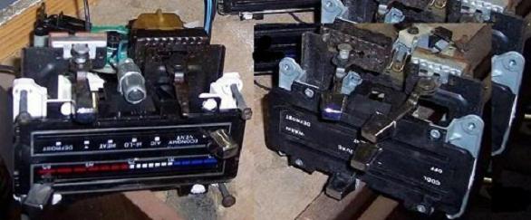

You will also need the switch box from an A/C car. In the picture below, the A/C switch box is on the left side and the non-A/C switch box is on the right side.

Post Options Post Options   Thanks (0) Thanks(0)   Quote Ranchero Fan Quote  Post ReplyReply Direct Link To This Post Posted: 11-February-2016 at 7:22AM
Location of the blower is different. Heater core is diff. too. A big project if done to be factory correct. Less of a chore if aftermarket system is used, but not cheap.
