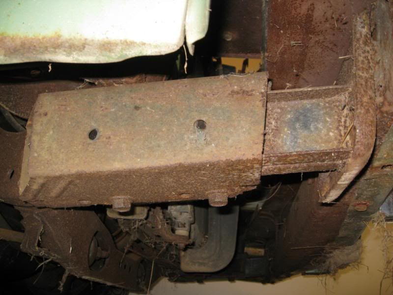

Hey 73ers, I've never taken the bumper off one of these beasts.  Here's a photo of the underneath area.  Do I just take out the three bolts and it'll slide off?  Any other tricks to it?

IF you can get the bolts to back out, in dealing with that impact type bumper, the bottom two and I want to say a third on the side?
My only suggestion is make sure to safely support the bumper during removal. I speak from experiance in saying alot of metal than can break bones.
Easiest way: torch the suckers.
{And I really wish I was closer. I would take the entire front clip in a heartbeat}

That's what I figured.  Take the three bolts out and get some serious lifting help to deal with the whole bumper.  Enrique' and Eddie are coming over to help me tonight.  Man, I wish you were closer too.  Hope you're doing better.  Paul~

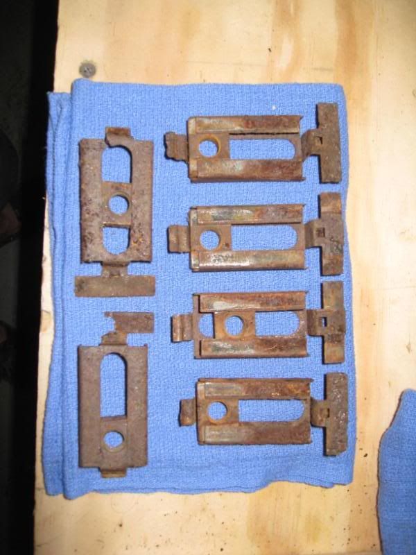

Here are the "famous" bolt retainers off the 73 front bumper.  Umm, Umm, good.  Smile

Geez, 4 of those look pretty good!  IMO, the engineer who designed these should be hunted down, drawn & quartered LOL

Until I pulled these out, I had never seen anything like it and suspect I won't in the future.  ConfusedJust a weird way to hold stuff together.  The metal on these parts is wafer thin as you can see a couple of them cracked when I removed them.  But your right about the other four a little media blasting/POR 15, they'll last another 36 years.  P~
