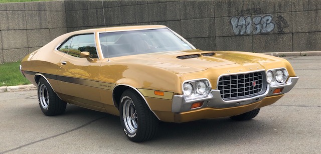

So the first time I took my wife for a ride in my newly acquired torino. 351 c 2v,, I go down town and put gas in it. I leave the gas station and start up the road and the car starts to die like its running out of gas. Lucky there was side street to swing into with no power steering. So I pump the gas and it starts back up , I run it a minute and it seems fine so I Drive it home without issue. I take the air cleaner off and rev the motor with a light in the carb and see plenty of fuel and the motor is running fine. So I go back out and drive it with no problems for maybe 15-20 miles. I took it on a couple of other short test drives since without issues. Today I drive the car about 5 miles and turn it off for 15 minutes, start it back up and start on my way home. On the way home it dies again and clearly is starving for fuel I manage to limp it home starting and stalling and pumping the gas . I take the top of the carb off and there is not much fuel , less than half. and I see little bubbles of fuel burping and farting around the shut off pin. I check the filter and it is clear and looks new, I take the shut off pin out and it all looks fine. I blot all the fuel out of the bowl , I crank the motor and fuel starts coming into the bowl and there are two places at the bottom that I can see the gas trying to boil. I check the pump and it seems fine I blow back into the tank and its under fuel making bubbles. everything seems fine. The motor was just up to temp with no signs of overheating. The fuel line is the factory steel routed through the front part of the motor ,not touching anything. So I am thinking its some kind of vapor lock issue? So all that being said is there some kind of known weakness on the 351c with maybe exhaust passages, ports, under the carb making things too hot? Nothing worse than something to worry about that you can't see. Hope someone can help point me in the right direction. Thanks in advance.

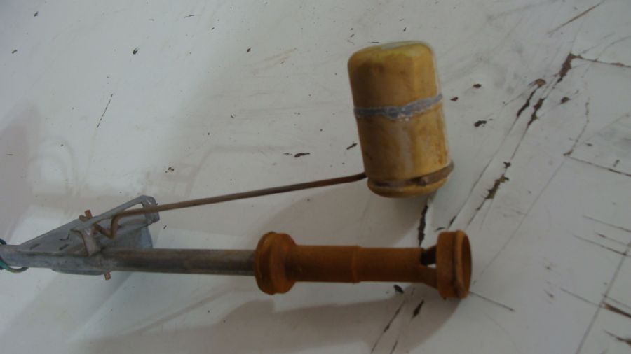

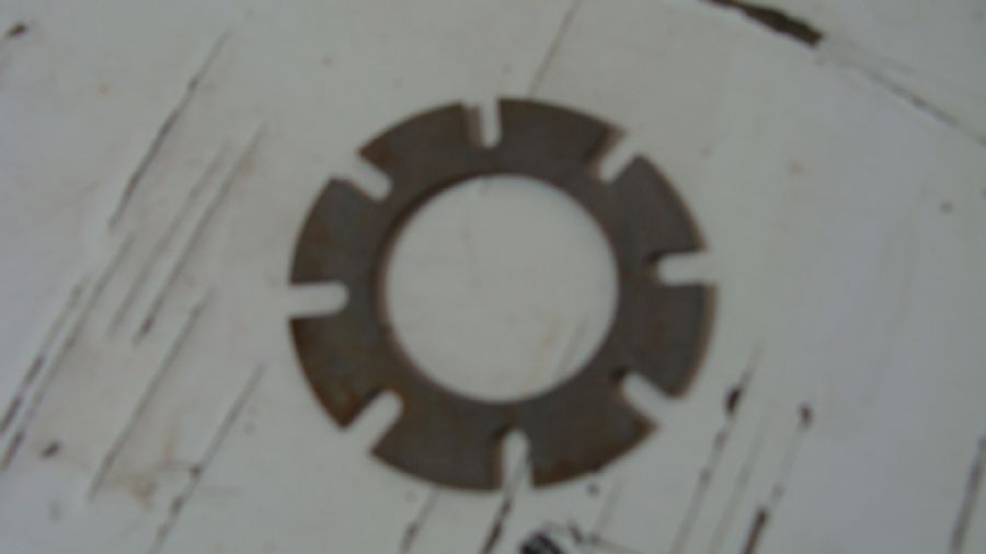

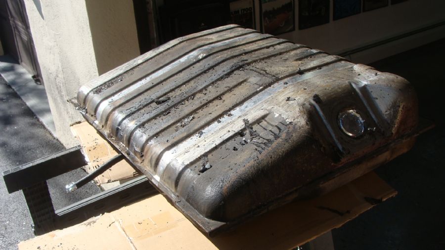

So while waiting for my insulator gaskets to arrive, I removed the tank and found that the sock at the end of the pickup has been falling apart and there was chunks of it laying around inside the tank, The inside of the tank is otherwise very clean. Maybe a little pc got sucked up into the fuel pump inlet and is causing a problem with flow at times ?? I'll blow out the line and maybe consider changing the fuel pump just to be sure.
Post Options Post Options   Thanks (0) Thanks(0)   Quote 72 RS 351 Quote  Post ReplyReply Direct Link To This Post Posted: 26-April-2021 at 2:44AM
That's a good clue, and a good bet the fuel pump has ingested something. The filter is upstream and protects the carburetor inlets, the pump has the sock in the tank.

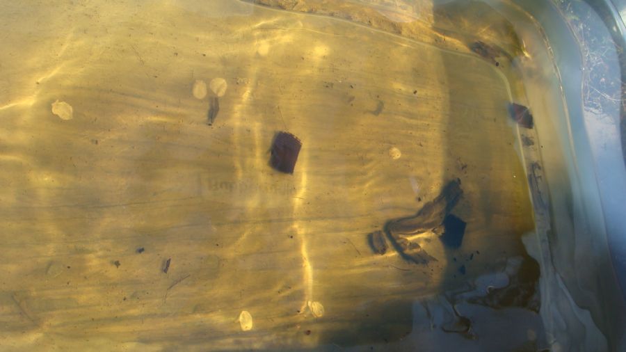

Post Options Post Options   Thanks (0) Thanks(0)   Quote 1beautifuldaughter Quote  Post ReplyReply Direct Link To This Post Posted: 26-April-2021 at 2:48AM
pictures of sock in fuel and a washer looking thing that was in the tank
