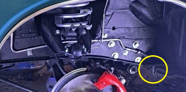

Post Options Post Options   Thanks (0) Thanks(0)   Quote Mthorpe93 Quote  Post ReplyReply Direct Link To This Post Posted: 05-April-2025 at 4:27AM
I don't have a convertible. But on my 68 cyclone the fuel line comes out into the front driver's side tire well and the into the engine bay just in front of the strut tower through the fender apron. It comes out right by the mechanical fuel pump. the 90ish degree turn is made with a soft line between the two hard lines.

Post Options Post Options   Thanks (0) Thanks(0)   Quote Mthorpe93 Quote  Post ReplyReply Direct Link To This Post Posted: 05-April-2025 at 4:28AM
It doesn't actually go through the firewall from what I remember. I will try and post a picture for you.

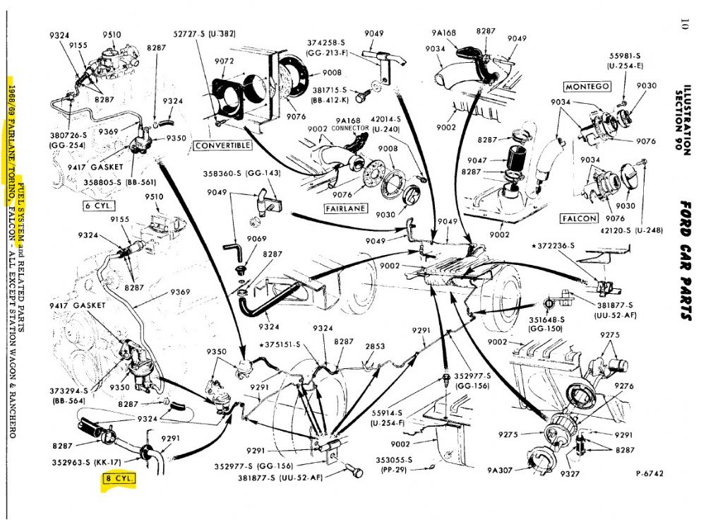

Post Options Post Options   Thanks (0) Thanks(0)   Quote schufitz Quote  Post ReplyReply Direct Link To This Post Posted: 05-April-2025 at 6:21AM
The fuel line comes up from underneath by the driver's side torque box. Then routes forward and into the engine compartment via inner fender apron.
Here's MPC diagram:
Also, try the attached link.  This came up on the Ford Muscle forum a while back and I replied with some info & pics.
