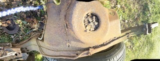

I ordered a pre-bent stainless fuel line to swap out the rusty one.
Does anyone know if there are any line clamps on the frame hump over the rear end? If there are I suppose I'd have to lift the body (wouldn't be a bad thing it needs new mounts anyway).

Driver side.... fuel line from sending unit.... 4 clips, one clip holds fuel line and brake line
Passenger side is fuel return line
