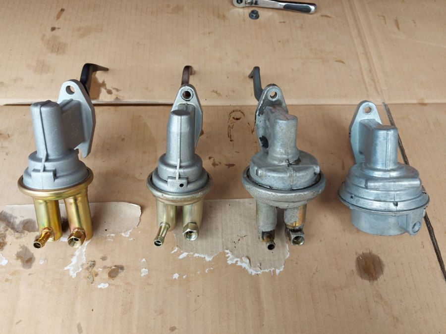

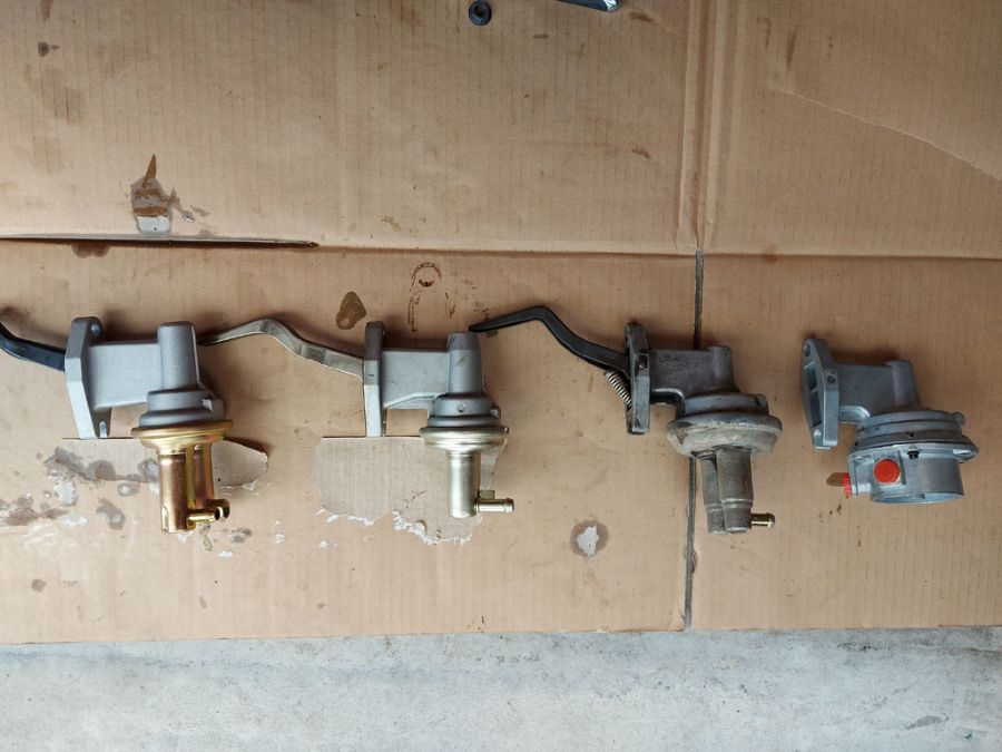

There is definitely some difference between the after market pumps.  Here is my comparison I did when I had my pump issues:
The Spectra pump is pump in on the left and it work fine.  The Carter pump is next to it and it was junk.  The third pump an original Ford pump and that last is an off shore hi-po pump.
You can read more about the pumps in my build thread. Scroll partway down the page and you will see the discussion on fuel pumps.
