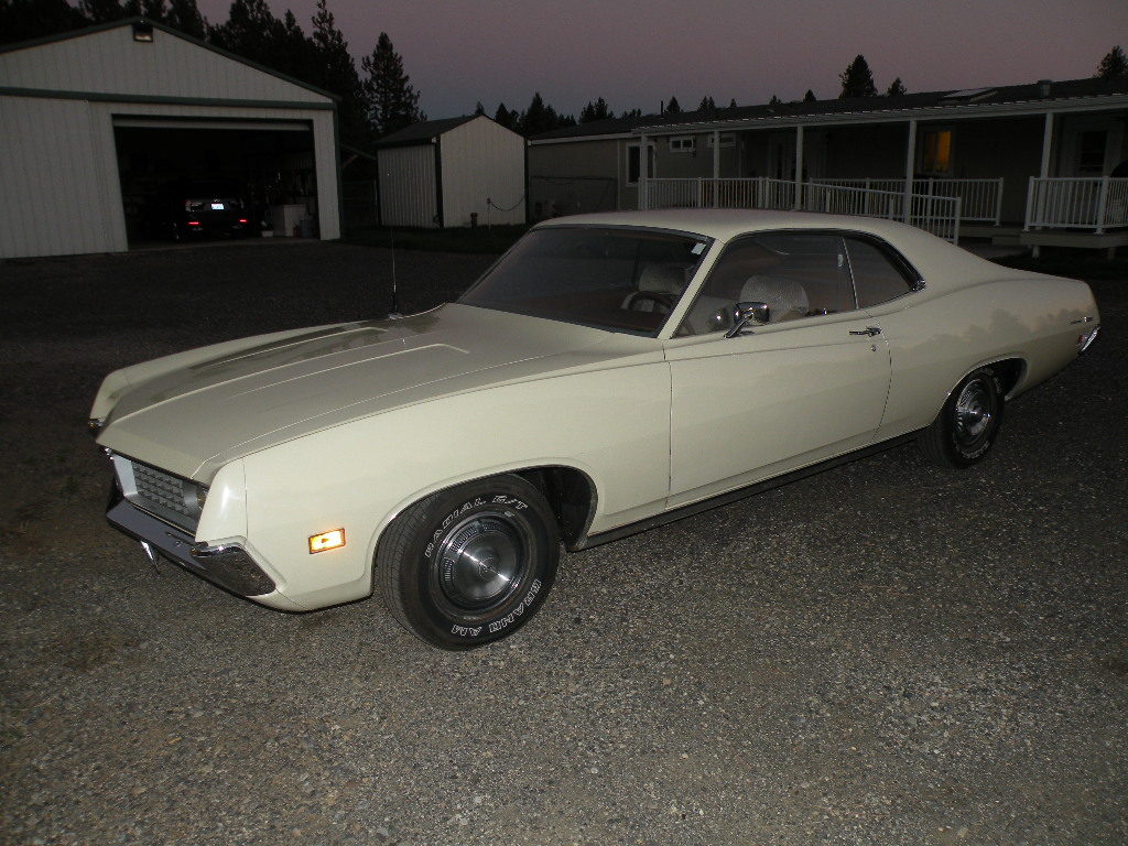

Here's a pic of my new baby, a grannie car with only 48k on it.
Points: 3038
Post Options Post Options   Thanks (0) Thanks(0)   Quote legend onirot Quote  Post ReplyReply Direct Link To This Post Posted: 22-September-2013 at 6:02AM
super nice!!
