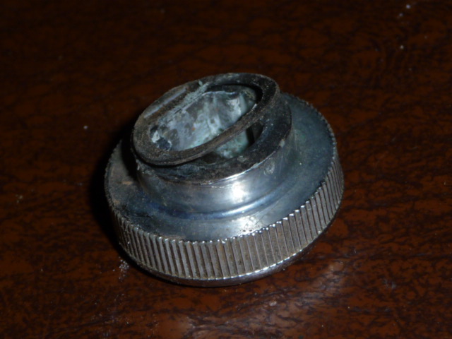

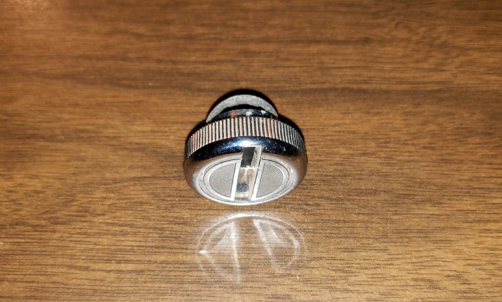

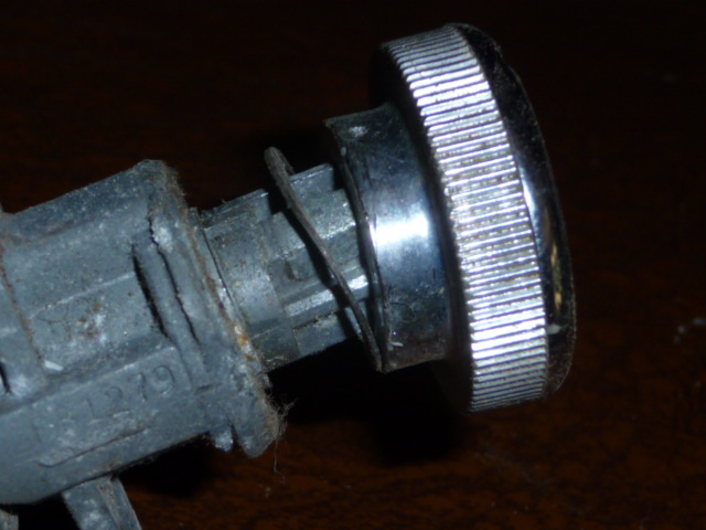

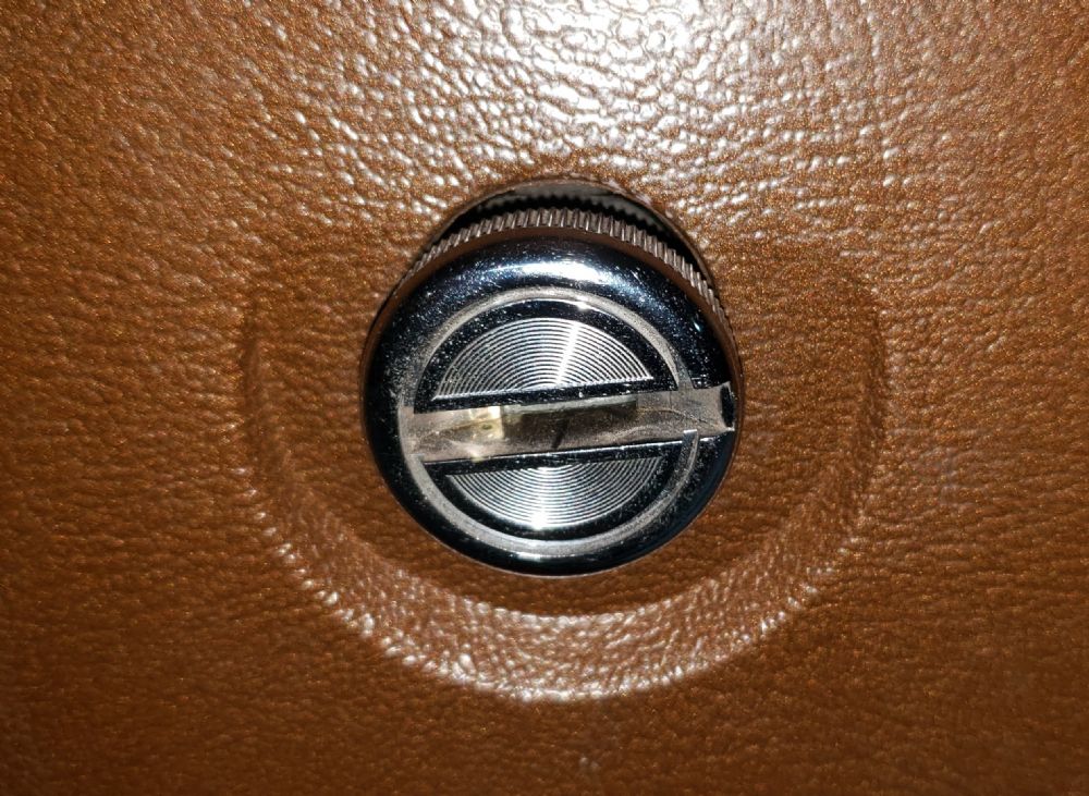

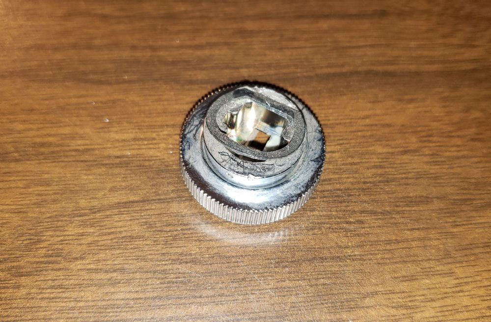

I was unable to add captions with the pictures so I'll try here.
1st is the knob showing the spring on the back.
2nd is the spring and knob together.
3rd they are separate.
You will have to remove the two screws/bolts from the back of the door.  Then it can be moved untill you can see the spring from the front.  Reach behind the spring with a small screwdriver and flatten it to the rear of the knob(towards the front of the glove box).  A little wd-40 couldn't hurt.
In the first post I was thinking of the wiper knob which I removed on the same day---
sorry.

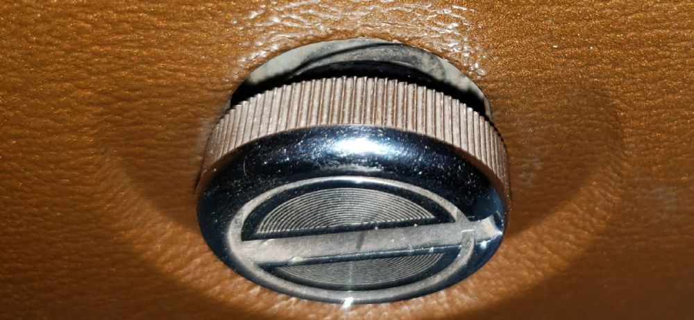

Post Options Post Options   Thanks (0) Thanks(0)   Quote TV 2M8O Quote  Post ReplyReply Direct Link To This Post Posted: 13-October-2025 at 12:34PM
AH HA!!!! Clap
Now to try my hand at it....

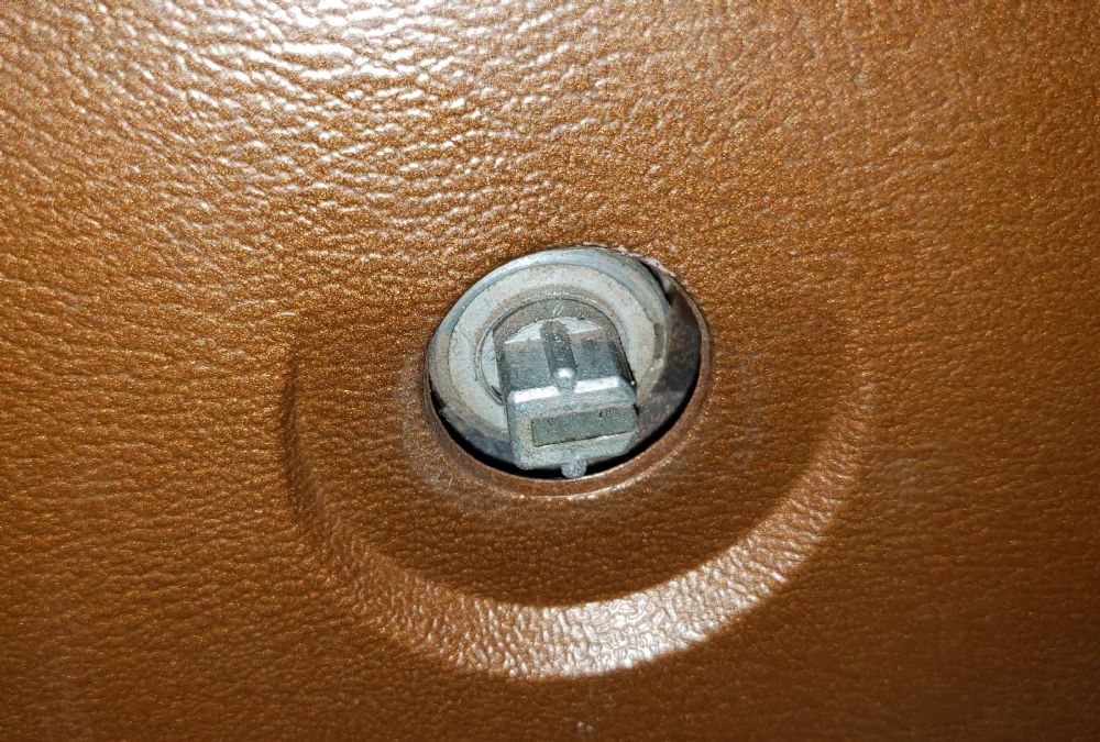

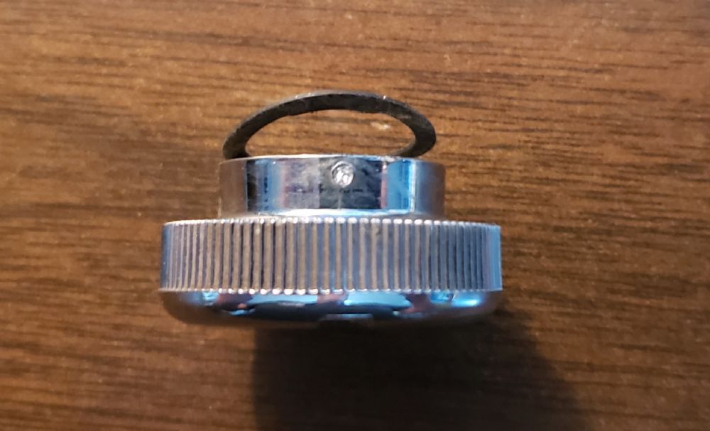

Post Options Post Options   Thanks (1) Thanks(1)   Quote TV 2M8O Quote  Post ReplyReply Direct Link To This Post Posted: 15-October-2025 at 5:42AM
After an extensive internet search, I discovered the trick for getting the knob off the glovebox latch!
It's tough to see down into the glovebox door cavity, but there is a "wave" spring clip attached to the knob that retains the knob onto the latch body...
There is a dimple on the shank of the knob that designates where to snag the spring clip to pull it forward to release the tension on the latch body and then pull the knob off the latch assembly...
I found that if you lock the latch, it puts the sweet spot at the 12 o'clock position allowing for easier access to the spring clip (discovered this after the fact!!)...
Once you've snagged the spring clip, pull it forward towards the knob and while pulling the knob away from the glovebox door, it will come off the latch.
Hope these directions are clear enough that it makes this an easy chore in the future!!
