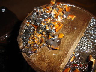

US 2V's are open chamber so not much shrouding as there would be in a closed chamber, and they don't pattern the plugs like that anyway. completely stock as in never been cracked open ever? i'm leaning toward valve guides and the seals are crumbled out. a little shade on the plugs i'm not worried about but the implications are disastrous. worn guides and stock valves lead to a dropped valve or valve head separation. the worn guide allows the valve to land on the seat out of position exerting awkward pressure where the valve stem and valve head are joined together by friction welding. enough awkward pressure and the friction weld fails and the valve head comes loose in the chamber. all sorts of damage, it can even punch a window through the cylinder wall. when my 1st Cleveland pulled this stunt, the valve stem got loose from the keepers and slid down the guide acting like a punch press making little slugs of piston material. real cool
bone stock 73 that's never been apart? guess what time it is! nice even compression at 125 on all cylinders, you can get away with cleaning out the oil pan, new oil pick-up screen, timing set & cylinder head rebuild. the important thing is to get rid of the stock valves! replace with 1 piece stainless steel single groove and locks / retainers to suit. the stock 'multi-groove' retainers won't work with single groove locks
and now i feel bad for you because you're gonna find the cam & lifters are shot too, and it's near impossible to get a hydraulic flat tappet cam through break-in these days.
the only lifters i hear about being recommended are Johnson Hylift and Rhodes
this is why you clean the pan & replace the pick-up screen
