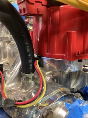

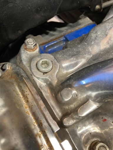

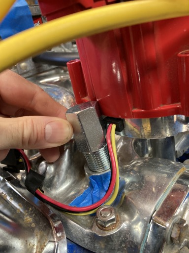

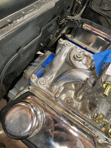

Here's the pics for the heater hose fitting and a possible relocation port at the back of the manifold. I'm not sure whether it's a viable option.
1968 TORINO GT, HARD TOP FORMERLY FORMAL ROOF, 302, C4
Post Options Post Options   Thanks (0) Thanks(0)   Quote Inkara1 Quote  Post ReplyReply Direct Link To This Post Posted: 26-October-2024 at 5:51PM
If you take the cap off the distributor, does it let the elbow be straight up to have the threads mesh together? It looks like when it's screwed in, the top of the elbow would be below the bottom of the cap. If that's the case, then pull the distributor, screw in the elbow until it's tight but the hose nipple points away from it and one of the six flat sides (instead of one of the six points) faces toward the distributor body, and then put the distributor back in. It might limit your range of timing adjustment, so hopefully your timing is set where you want it already, but it seems easier than trying to get that rear crossover to work, since the ports look to me like they're smaller than the one by the thermostat.
Post Options Post Options   Thanks (0) Thanks(0)   Quote 72 RS 351 Quote  Post ReplyReply Direct Link To This Post Posted: 27-October-2024 at 6:14AM
That rear coolant passage is not made into any later intakes by design. But it should work for the heater core purpose if you need to. There are several different OEM coolant pipes made to connect up front like that, and mounts to the intake with an outlet at the back. The Explorer 302 was the last production SBF, you should be able to find those still if you hunt for a while. I don't know what the height is of that metal swivel fitting where it goes into the intake. Hopefully some are shorter than others.

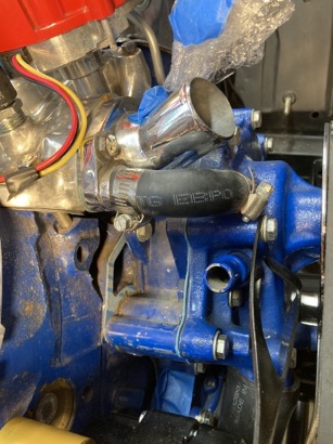

pic of your water pump, are there 2 heater connection nipples on it?

the plugs at the rear will give coolant that has only gone through the block, not the heads and will not be fully hot for the heater core. some engines like Pontiacs connect the heater core to the rear of the passenger side head, once the engine is fully warmed it won't make a difference

Thanks for the suggestions, guys. That 90 I have won't fit under the distributor when it's threaded in. The rear port does turn out to be a smaller thread diameter than the fitting but I might be able to find a smaller one if necessary. I don't see a brand name on the intake. I did get a straight fitting that fits, but will still limit timing adjustment. I found a more compact 90 on amazon and though it's $35! I might order it. Here's a couple pics, including one for Rockatansky of the water pump.
