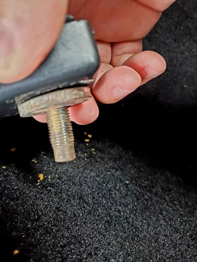

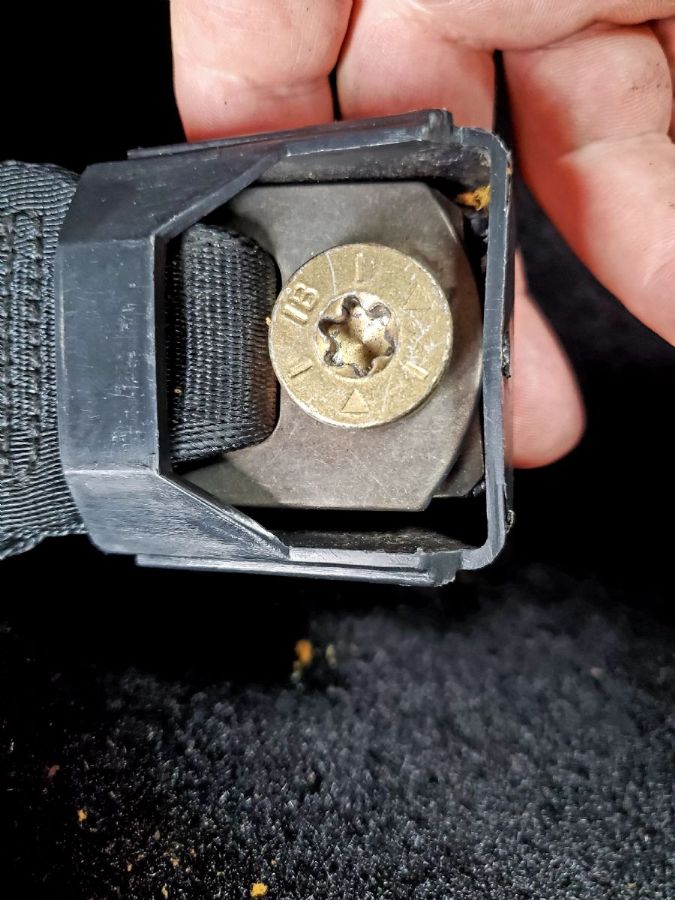

Correct bucket seat belts don't have the offset in the anchor end brackets.
They will have the plastic covers to support them and they are directional. Should be very obvious Left vs. Right. There may be a plastic loop on the seats they pass thru, to support them so you don't have to dig around and find them between the seat and console.
There should be a washer that seems to go between the anchor bracket and the retaining bolt. If you put it between the anchor bracket and the carpet it comes off the bolt shoulder and is a pain in the ass to tighten the bolt.

Post Options Post Options   Thanks (0) Thanks(0)   Quote Steve M. Quote  Post ReplyReply Direct Link To This Post Posted: 27-June-2020 at 8:31AM
Post Options Post Options   Thanks (0) Thanks(0)   Quote Steve M. Quote  Post ReplyReply Direct Link To This Post Posted: 27-June-2020 at 8:32AM
Post Options Post Options   Thanks (0) Thanks(0)   Quote Steve M. Quote  Post ReplyReply Direct Link To This Post Posted: 27-June-2020 at 8:34AM
Post Options Post Options   Thanks (0) Thanks(0)   Quote Steve M. Quote  Post ReplyReply Direct Link To This Post Posted: 27-June-2020 at 8:37AM
slide the cover off and unbolt the complete assembly.

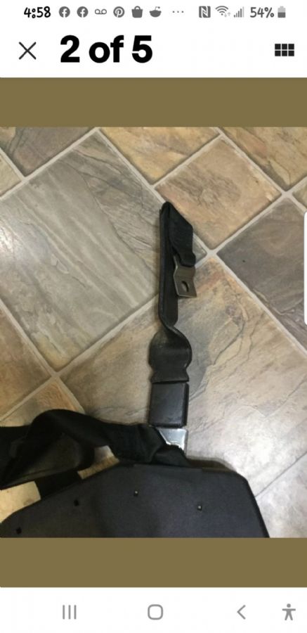

That is very interesting Steve.
I was looking on Ebay and found a female buckle from an NOS kit and it has the offset. Is this offset only used with a bench seat that has the extra buckle in the middle?
Jim
Post Options Post Options   Thanks (0) Thanks(0)   Quote californiajohnny Quote  Post ReplyReply Direct Link To This Post Posted: 27-June-2020 at 10:55AM
the twist in the female part is for a bench seat
Post Options Post Options   Thanks (0) Thanks(0)   Quote Steve M. Quote  Post ReplyReply Direct Link To This Post Posted: 27-June-2020 at 1:41PM
It is. The center buckle fits into the offset.

I have a washer on each as well as the big spacer. but i also appear to have used 2 center belts.
Probably the ones that were easiest to get the twisted covers off.
I had several sets of belts to pick the best parts from.
