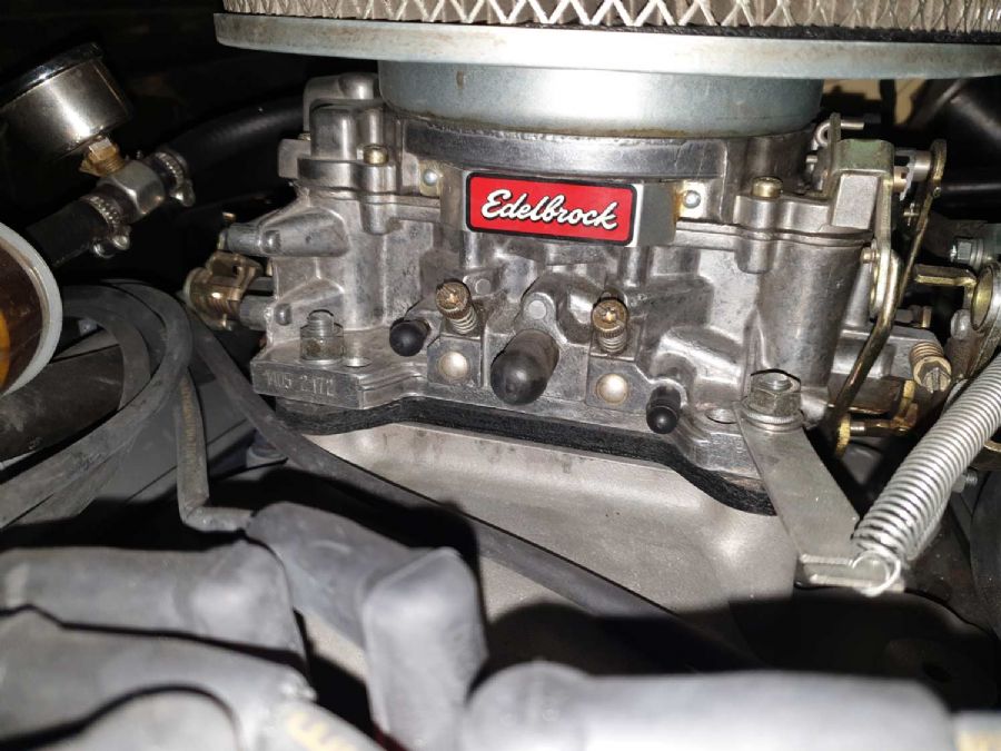

Hello,
I've bought a GTS 1972 with a 351C-2V engine in Riverside. After 2 Years I got an engine damage.
So I decided to buy a 351C-4V (short chamber, 1970) here in Germany. Its from a pantera with flat top piston HP555 0.20.
I installed a LUNATI CAM, a BLUE THUNDER and an Edelbrock Carburator (1405). Now my old HEI was to big. I bought an new distibutor in germany but it was trash - first the cable power was to low, if I make more than idle speed the engine goes off. Then I made a relais to bring more power to the distributor - it works but I'm not able to setup the engine it good. I've tried much settings for idle, 6btw, 8, 10, 12, 16...but always I come over 45 if speed is over 3000 or idle is to low and no power - this is too high and the engine does not hang well on the gas. The Distributor is bad, so I need a new one.
Second Problem, if the engine is hot and I turn it off, it is dieseling/turn false direction - I think the Problem is wrong time setting and bad distributor.
I'm looking for a good distributor and coil for this engine that fits and have enough to make a good setup.
Also I need some experience from people who have such an engine or can help me to find the 300HP or more. Should I Change jets from carburator?

It sounds like you are getting way too much mechanical advance in your distributor. If you want to replace your distributor I would recommend looking at this one here:
I have one of these as with a coil from a 1995 Mustang 5.0L engine. It works great. I have about 16 degrees initial with 36 total all in before 3000.  If you do decided to run this setup, I can send you a copy of my wiring diagram.
If you want to build a cheaper system, you can use a GM HEI igntion module, a Ford Dura Spark distributor and the above coil.  Look at this thread below and it has all kinds of details on that ignition and other options.

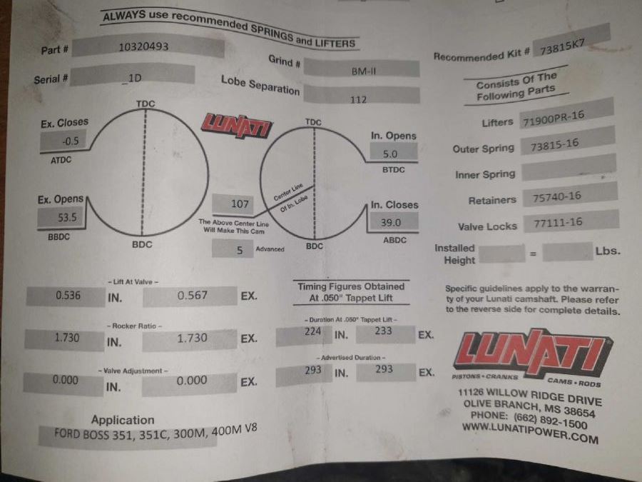

6er have the heads been set up specifically for the Lunati cam?
.536/.562 lift will require valve springs and retainers compatible for extra valve lift over stock
do you have a vacuum gauge, how much Hg does the engine pull from the intake manifold at idle?
here's the Lunati page for your cam,

Good morning,
in the 351-2V was a comp cam kit (K32-221-3). From this kit and other parts from the engine there are the springs (outer) and the crane rocker arm conversion kit. Also the rocker arms (1.72 - Summit Racing® Cast Steel Roller Tip Rocker Arms SUM-141709PL). I ask the dealer where I ordered the LUNATI CAM If I can use this parts or need new. He told me it is good and I will not feel the difference between 1.72 and 1.73, so I put all in the engine.

Yes absolutely that Lunati cam has no love for vacuum, i wish they gave the seat to seat overlap
"Hydraulic Flat Tappet. Good cam for improved mid range torque and HP over stock.
Needs 2000-2500 RPM stall converter, headers, 9:1+ compression ratio and 3.73 gearing. Fair idle.
Advertised Duration: 290/300 ; Duration @ .050 (Int/Exh): 224/234
Gross Valve Lift (Int/Exh): .536/.562 LSA/ICL: 112  RPM Range: 2000-6000
notice the Lobe Separation Angle and the Intake Center Line are the same at 112*, there is no advance ground into the cam, this cam has true 'straight up' timing. if it doesn't get degreed to spec, and possibly installed retarded, low end response, efficiency and vacuum will suffer more. it can be installed advanced with properly checking for piston to valve clearance, there 99% won't be any issue but if it doesn't get checked and things go bad there will be no joy in Mudville

the thing is what you have there needs to be checked and evaluated for compatibility. your engine was born at least 45 years ago, anything may have been done in that time. if the spring seats have been cut for dual springs that needs to be identified before selecting a spring, and the retainers are specific to the spring OD and ID also. retainer locks are specific to the valve stem diameter, retainer lock angle and groove type. way too much to guess from this side of the planet!
there's a ~possibility~ that your springs are OK but my $2 are against it.

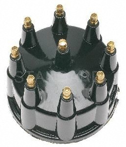

there is also a male terminal small cap to use HEI style leads,
only issue i've heard is the clip pockets can be a little tight
Standard Motor Products AL482

@John do you have with male terminal?
Post Options Post Options   Thanks (0) Thanks(0)   Quote californiajohnny Quote  Post ReplyReply Direct Link To This Post Posted: 07-February-2020 at 10:08AM
i'd have to look?  i just swapped distributors to fire it up the caps interchanged
