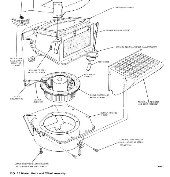

Sorry to bother again, I ordered the blower and fan but doesnt seem to mount properly, is there housing for it? Is it possible someone could post a picture or two of their car under the dash where the fan sits, any help much appreciated. Thanks
