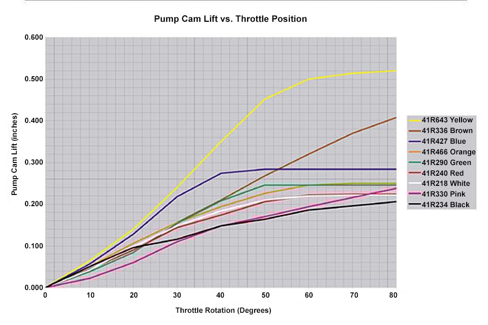

How far open are the idle screws? Those affect low rpm only and not upper rpm fuel at all. I'd richen those if they have adjustment left, and see how that does.
Also what size squirters does it have, and is the soft low end right off idle? The squirters help the initial hit, and note too that the extended tips add fuel to higher rpm airflow. So those optional tips can be used to very slightly richen high rpm.

I think I have 28 squirters, just the standard (non-nozzle type) and I am using the orange cam.

I can mask the issue just as you did with running a green pump cam and a 35 squirter but if you hold it steady just at the right spot you feel/see the the lean spot just before the boosters start flowing.   Seems to be a known issue with this carb from all my research I have done.

counterintuitive on it's face but a smaller accel pump nozzle extends the duration of the pump shot,
i wonder if this approach might cover the lean spot?
maybe a longer duration pump cam also?
