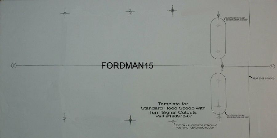

I believe I have found the correct template for this application. The seller does not indicate the vehicle type, but the template is a perfect match for my oem non functional scoop.. Purchased it and will update you on how things work out..
Post Options Post Options   Thanks (0) Thanks(0)   Quote hogfiddles Quote  Post ReplyReply Direct Link To This Post Posted: 19-July-2019 at 5:27AM
that just shows you the bolt holes and the turnsignal holes.... it does not show you the 4-hole oval.  The oval is there regardless of whether it is a "functional" scoop or not.....

Hogfiddles.. You are correct. I was searching on line and actually saw the 4 large holes in the hood.  I'm not going to cut those out.  My hood is original and fits perfectly, so the mounting holes and small bulb access holes will do for now.. Thanks for the update.. Good catch..
Post Options Post Options   Thanks (0) Thanks(0)   Quote hogfiddles Quote  Post ReplyReply Direct Link To This Post Posted: 20-July-2019 at 3:15PM
ok, cool.  If you do decide to make the rest of the cutouts, let me know.  I saved the center of my old hood, so I can always trace the EXACT shapes
