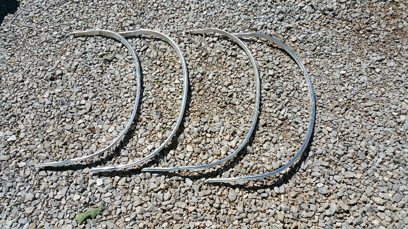

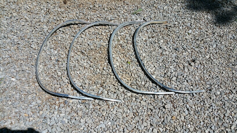

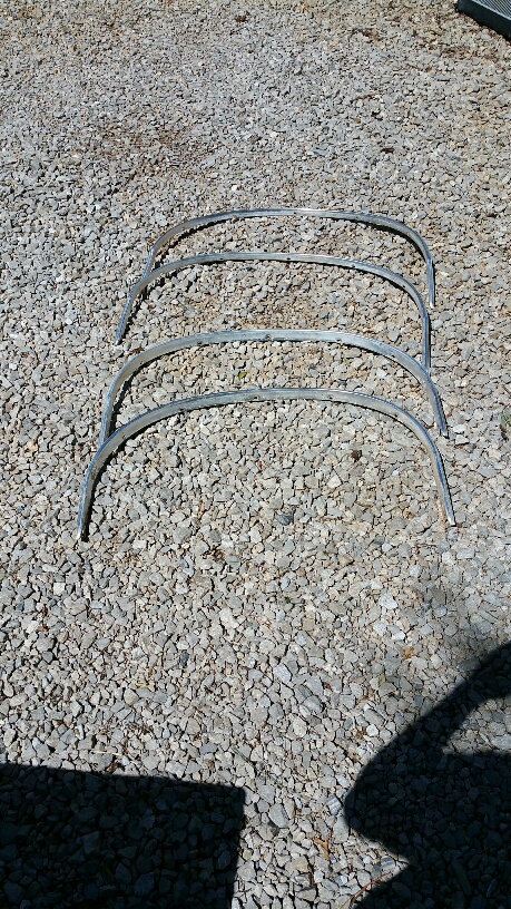

Some Quick info:
  • The 1972 Front wheel lip moldings (full length) are a one year only part.  However, it is also used on 1972 Rancheros (front) - all Rancheros used the full length moldings. These will not interchange or physically fit 1973-76 Torinos.
  • The Front 1973 Full length moldings are a one year only item, however, they will physically fit other years - 1974-76 Torinos.  The only difference again is the 1974 -76 moldings typically have flattened areas to accommodate rocker/fender trim
  • The rear full length wheel lip moldings are identical between 1972 & 1973 and they will physically fit all 1972-76 Torino (2-doors and 4-doors - not Rancheros) BUT they do not have the flattened out areas to accommodate rocker or other lower fender trim.
Here are some pics I dug up:
1972 moldings photos (Joe Lombardo's)

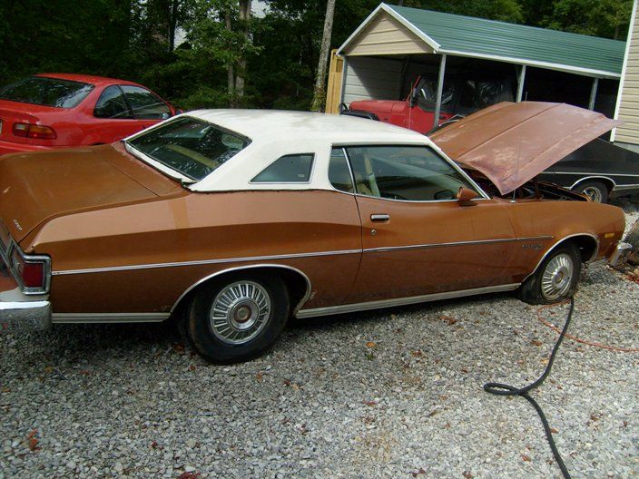

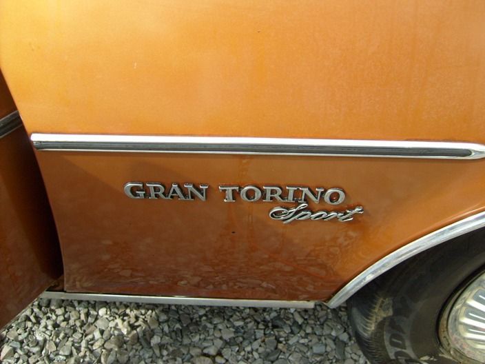

The later cars had flattened sections on the moldings.  This Torino has rocker moldings and the lower fender/quarter tirm and so the wheel lip moldings are flattened to accommodate these change.  This is really the only difference from the 1973 cars.

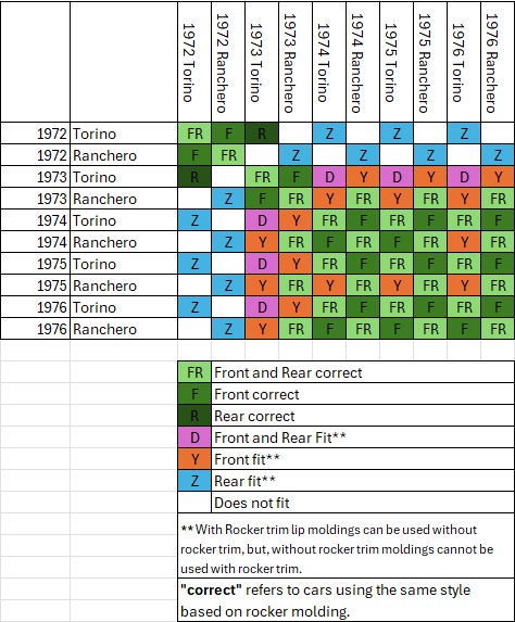

I am trying to assemble a matrix, though Vince's bullets are pretty clear. Thoughts?
DRAFT - FEEDBACK PLEASE

Post Options Post Options   Thanks (1) Thanks(1)   Quote 72FordGTS Quote  Post ReplyReply Direct Link To This Post Posted: 10-July-2025 at 4:14PM
Your matrix is great!  There are a couple of changes needed though. 1972 Ranchero rear moldings would fit all 1972-76 Rancheros.  Also, it is somewhat confusing to rear without the years not listed across the top.
Instead of using "C" for rear correct, what not use "R"?  I think this would also make it easier to understand.
This is a great idea!  Nice work Pete!

Thanks, heres a new version..still DRAFT FINAL

Pete,
nice job!  should you differentiate between styles of Torinos with body moldings vs. not?
this matrix will help a lot of members out.

Probably should, but that may be a deeper rabbit hole with the color variations that exist. I'll label this Full wheel lip moldings,  and if anyone wants to drop info on full body ones, I'll put it together.

It looks great to me now Pete. Are you going to supply this to Metro Obsolete?
When I have time, I will add in extra info about the other years and variations.

Thanks. I have sent it on over to them.
