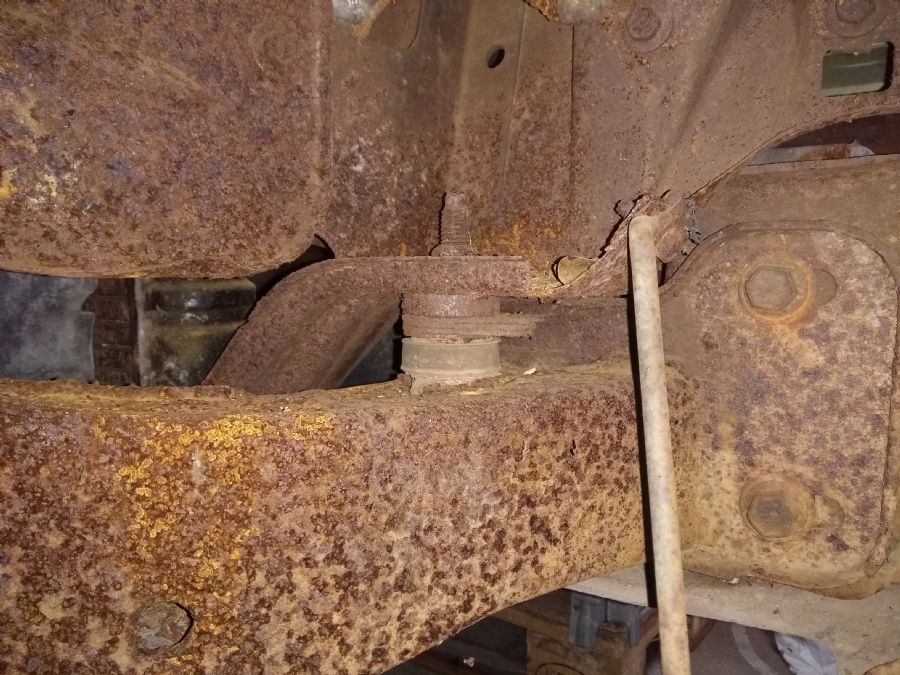

I have read this thread 100 times....fascinating! As I will be changing all bushings soon.........I have gathered the Crown Vic kit AND the Energy Suspension(for core support) are the best alternatives to the originals.
Here is a nice picture of my original core support bushing...

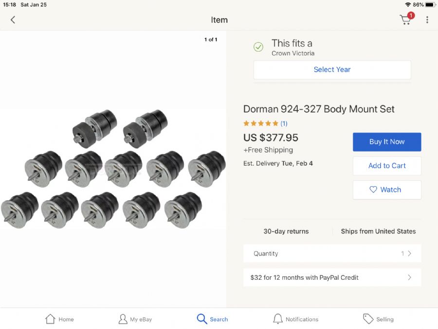

Hello again. There is a Crown Vic kit on Ebay....but heck....it costs 350 bucks!,  seems very expensive!
Of course it comes with all mounting hardware...but still...expensive.
Any ideas appreciated....thanks.

Post Options Post Options   Thanks (0) Thanks(0)   Quote Anderslober Quote  Post ReplyReply Direct Link To This Post Posted: 28-January-2020 at 12:15PM
I went ahead and bought the above CV kit. Friggin’ expensive!!!
I will buy the Energy Suspension kit for the core support too.
Let me know if I have messed or anything. Thanks.

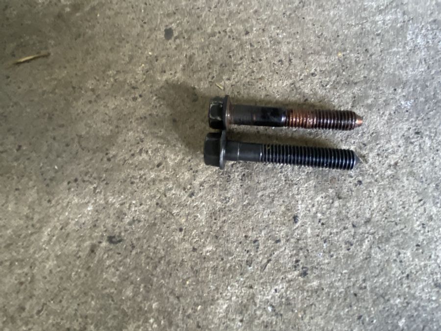

Post Options Post Options   Thanks (0) Thanks(0)   Quote brandonc Quote  Post ReplyReply Direct Link To This Post Posted: 21-April-2020 at 4:06PM
this is my 06 crown victoria front isolators. they squeeze down alot for the right application.
i got the same Dorman kit for 73---you may check Rock auto for a better price!
brandon

Post Options Post Options   Thanks (1) Thanks(1)   Quote 72FordGTS Quote  Post ReplyReply Direct Link To This Post Posted: 04-March-2023 at 9:17AM
Chevelle body bolts will work in place of our OEM Torino bolts.  See the post below from Compton's build thread for details
Originally posted by Compton Compton wrote:
For those looking for an alternative to corroded body bolts 72 Chevelle work mint and are available new…basically identical….threaded shaft is longer on the Chevelle bolt and the pointed end is slightly shorter but neither of these make any difference to installation….
