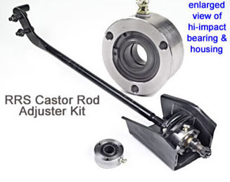

There are a few different designs floating around now. I'd be interested to see what design is chosen for a small run. Any ideas?
I count 3 bolt on options.
Originally posted by Global West Global West wrote:
Originally posted by RRS RRS wrote:
Originally posted by cggrob cggrob wrote:
I personally like how easy the RRS is.
I was kinda playing with a similar design for our stock rods. Like this..
Obviously with a spacer between the bearing and the seat that the washer usually sits. I left out all the hardware and stuff too. The caster is adjusted by swapping spacers. This could be very cost effective and a totally bolt-on affair. I just don't like axial load on sphiricals but using a safe number of 15% radial load limit for the axial load limit, a bearing to fit this application wouldn't be anything exotic. The rod is weak in comparison. The only reason I didn't do this is because I don't think the rod is strong enough for what I am doing around that 5/8 thread and of course the axial loading issues.

That is basically that RRS solution.  Worth a try.
I think the heim bearing option looks good especially if they fabricate a better strut rod to go with it.  Its proven, easy to maintain, easy to get parts to replace the rod end if needed.
I'm thinking that you don't see that much axial load on that strut arm.  Its the suspension compression and forces from a bump from something like a pothole that would shock the arm.  If you can figure out the loading with the suspension compressed and the shock load from the lower control arm pulling on the rod while the suspension is compressed that may be the max load you'll see.
 I have no way to know for sure.  Your guess is better than mine.

The picture I posted above of the nascar suspension still uses bushings, but the rods are heavier, and they used BIG sleeves for adjustment.
If I was going to use a stiffer bushing,  I wouldn't want the strut rod necked down where the threads are.
I would like to see how the Global West design works in the real world, the RRS design seems like it would be good as well. I just wonder where these designs will move the "Fail-point" to.
