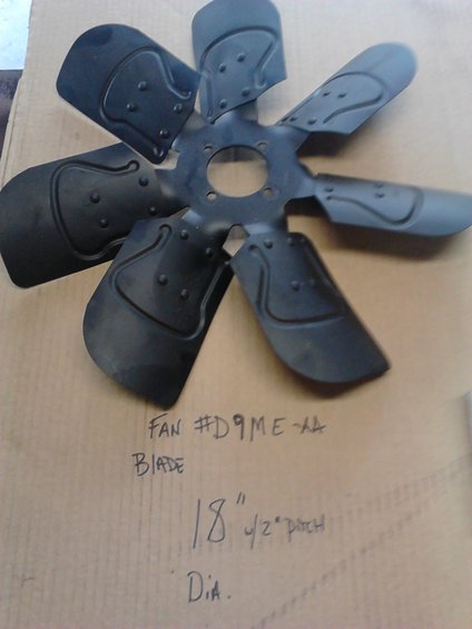

I went through this a little when shooting for the best in cooling fan/fan clutch. A Hayden 2711 will also fit and it is about 5/16"-3/8" shorter, to accurately choose the right one will depend on the relationship between fan blade/shroud placement, the fan blade "should" be a bit over 1/2-way into shroud-closer to the radiator(or just less than 1/2-way out) for best performance . I have a factory 7 blade clutch fan that will fit this clutch (if you are interested). If you want the "ultimate" cooling from a factory based fan clutch/clutch fan get a clutch fan for a mid-late 70's F250-F350 w/ 460 and a Hayden 2799 fan clutch. I have both of these fans and the truck fan has a bit more pitch to the blades. Couple of pics:
D9ME-copy of '75-'76 T-bird clutch fan, has 3.00" bolt circle
D6TE SD clutch fan, has 3.25" bolt circle.
Hope this info is helpful.
BTW, Hayden changed their #'s for whatever reason, original 2710 is now 215011 and the 2711 is now 215012.

Hey Todd, thanks for the response.  The 2711 is the clutch they list for the cars with the 460, that's why I figured the smaller 335 series engines used a longer 2710 since they are physically shorted.  Maybe I will just order the 2710 locally and try the fit.  My parts store is usually okay for returns.
I would be interested in that fan, at lest the smaller 18" T-Bird fan.  My shroud will not take the larger truck fan and I don't think I need that much cooling anyway.  I'll PM you.
If anyone else has done this conversion with a car that has a 351C/400/351M or has a factory setup, please let me know what you used.
Vince,
 I sent you a PM, shipping charge is fairly STEEP between the U.S. and Canada. I will say and some may not want to hear this or will agree with it, but the best thing I did for my cooling system was converting over to dual electric fans and adjustable fan controllers. More power, better MPG and better control in cooling.
