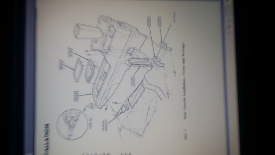

Not sure if I can take a screen shot and email it to myself but will try later.

Post Options Post Options   Thanks (0) Thanks(0)   Quote Uante Quote  Post ReplyReply Direct Link To This Post Posted: 10-July-2019 at 3:47PM
That's a really good diagram of the mounts, console and accessories!

The front bracket is held in with rivets. Not sure how to locate the bracket. Here is what I have in my car.
Post Options Post Options   Thanks (0) Thanks(0)   Quote handsofstone Quote  Post ReplyReply Direct Link To This Post Posted: 11-July-2019 at 5:07AM
Post Options Post Options   Thanks (0) Thanks(0)   Quote handsofstone Quote  Post ReplyReply Direct Link To This Post Posted: 11-July-2019 at 5:09AM
Not sure if this diagram is any clearer.
Post Options Post Options   Thanks (0) Thanks(0)   Quote Big Bird Quote  Post ReplyReply Direct Link To This Post Posted: 11-July-2019 at 10:31AM
All the locations key off the raised brace in the floor.

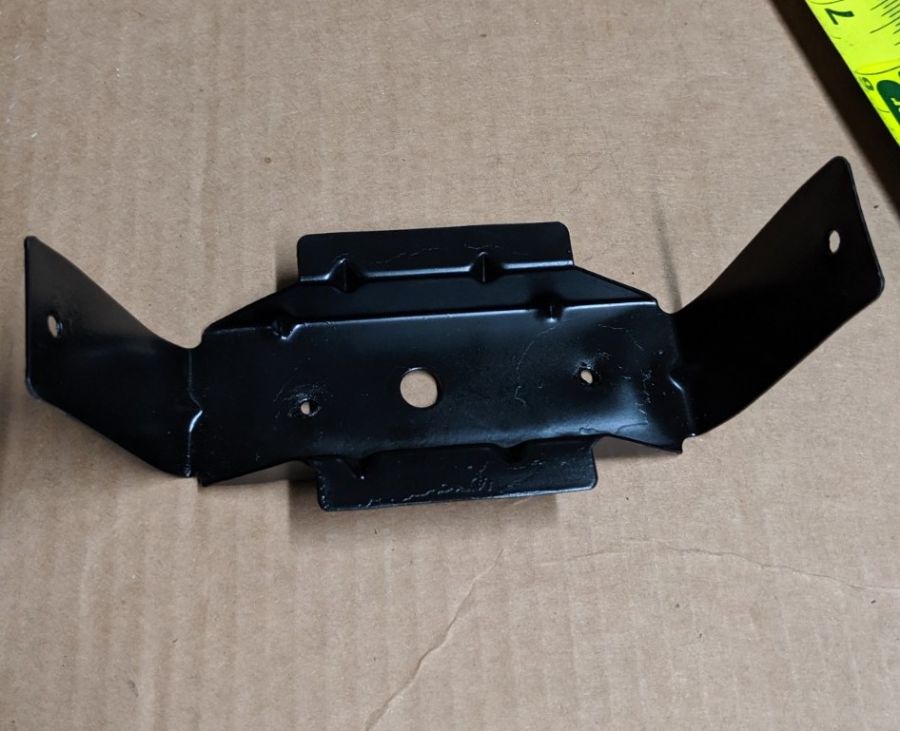

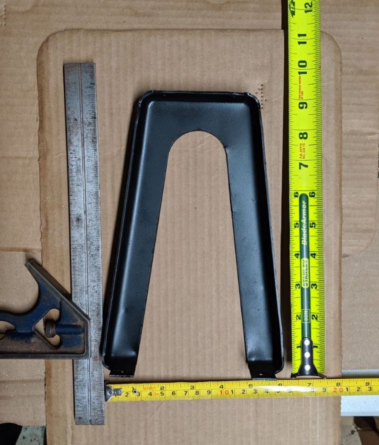

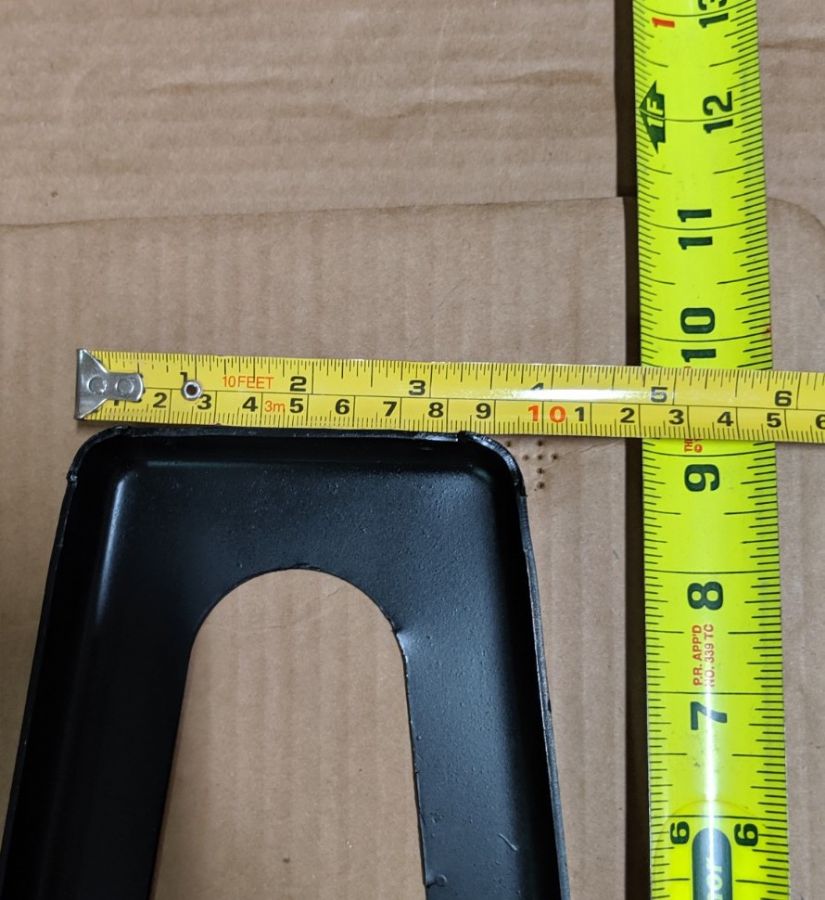

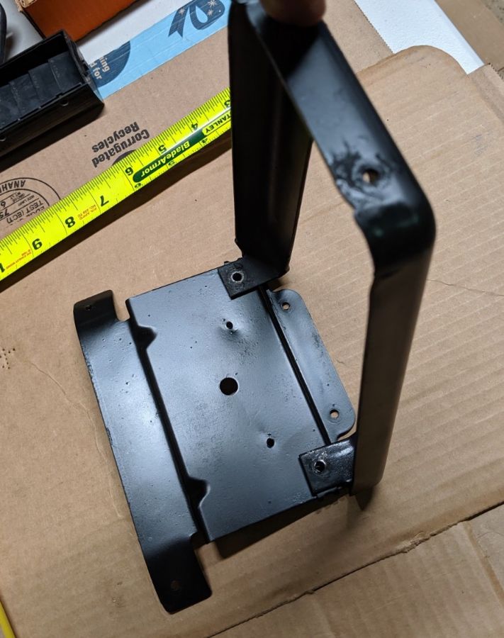

Here's some pictures of sizes and such for the Arch bracket and base plate.
It's about 6" wide and 9" tall.
Close up of Corner attach point
Measurement across top
Offset lower attach holes
Hole spacing, just needs to match whatever you make the base plate to.
Base Plate
Attach configuration. Two holes on forward tab are for attaching to car hump. Two holes in the middle by the larger hole are for attaching through the bottom of the console glovebox. And two more attach holes in angled rear tabs.
Side profile of Arch mount.

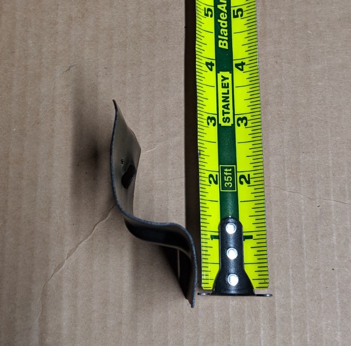

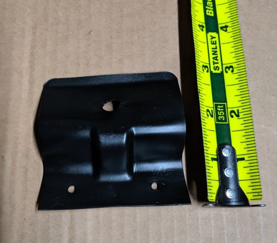

Some shots of the rear and front brackets
Rear Bracket. Console attaches to it through the rear of the console glove box floor.
Profile of height for hump attachment
Bottom view
Front Bracket
Profile of front bracket. My front hole that this feeds through is broken as most are I think. I'm going to make a metal plate for inside and outside of feed through area and rivet them together once I get my car back and can verify fit and everything.

Post Options Post Options   Thanks (0) Thanks(0)   Quote handsofstone Quote  Post ReplyReply Direct Link To This Post Posted: 13-July-2019 at 6:50AM
Nice writeup. Even I could fab those. Clap

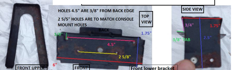

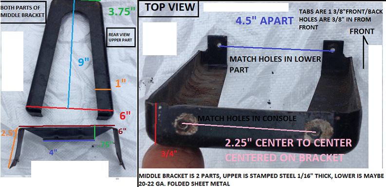

Post Options Post Options   Thanks (0) Thanks(0)   Quote Big Bird Quote  Post ReplyReply Direct Link To This Post Posted: 13-July-2019 at 6:56PM
Some pics with dimensions I sent someone about 5 years ago.

I just want to post a thank you to all who are participating in this, we are definitely getting enough information and pictures to make this a very doable project.  When John gets the tunnel measurements (no rush on this, John, I won't be putting the console in for a while yet) we should have all the information we need.  I am also starting to make a filler piece for my beaver area but due to the irregular outline of the section I may first smooth it out to hopefully make it easier to fab a piece to fit.

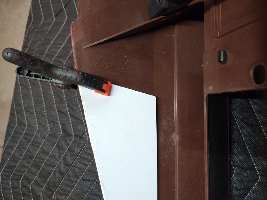

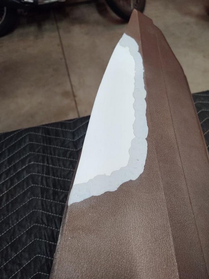

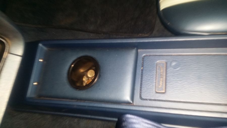

 I am not at the point yet of installing my console so I decided to work on the cut out section on the side of the console.  I picked up a package of plastic sheets at the local Ryders Hobby shop store
I then made a cardboard template of the missing section
After transferring the outline onto the plastic I attempted to cut the plastic with a scroll saw.  This did not work very well due to the plastic melting as it was cut making precise lines very difficult.  After some fine tuning with a file I got a pretty good contour of the piece.

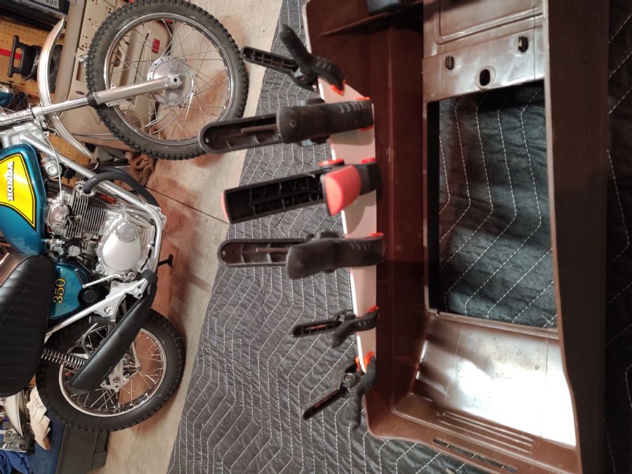

I then cut a backing piece to glue to the inside of the console for the filler piece to rest on making it flush with the outside of the console.
I then glued the filler piece onto the backing plate and the console.

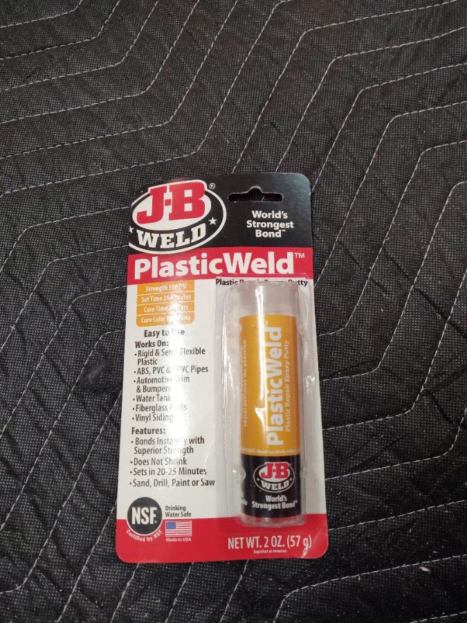

  After it dried I used jb weld plastic weld to fill in where the filler piece meets the console and sanded it down.
I will be using some texture paint on the lower section of the console to help blend it into the pattern.  I will post additional pictures when I get done painting it.

Post Options Post Options   Thanks (0) Thanks(0)   Quote hogfiddles Quote  Post ReplyReply Direct Link To This Post Posted: 05-December-2019 at 12:30PM
you DO realize that the contour on the left side of the console IS  different because of the hump, right?
1973gts View Drop Down
Joined: 05-March-2018
Location: Grand Rapids Mi
Points: 720
Post Options Post Options   Thanks (0) Thanks(0)   Quote 1973gts Quote  Post ReplyReply Direct Link To This Post Posted: 05-December-2019 at 1:53PM
The contour is different on a floor shift car but mine is a column shift so no hump, I just wanted to fill in the missing section so there isn't a big gap on the drivers side.
