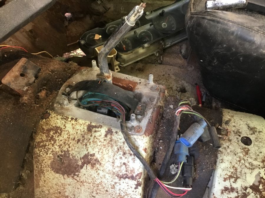

Post Options Post Options   Thanks (1) Thanks(1)   Quote hogfiddles Quote  Post ReplyReply Direct Link To This Post Posted: 26-March-2022 at 4:08PM
here’s a pic from before I tore things apart…… you should be able to extrapolate from there……
Post Options Post Options   Thanks (0) Thanks(0)   Quote hogfiddles Quote  Post ReplyReply Direct Link To This Post Posted: 26-March-2022 at 4:19PM
Originally posted by Uante Uante wrote:
Great picture of the floor and brackets. I'll be needing all brackets if anyone has extras. Not sure I can use a front one as the piece where the slot is, is broken off my console like a lot of others I've seen.
They’re mostly broken because people take the screws out and then pull/yank, not realizing that they need to slide it FORWARD the unhook from the front yet. The plastic is very brittle, and it doesn’t take much pulling or lifting to snap it. It snaps so easily that just about nobody even feels that it was hooked to begin with.
