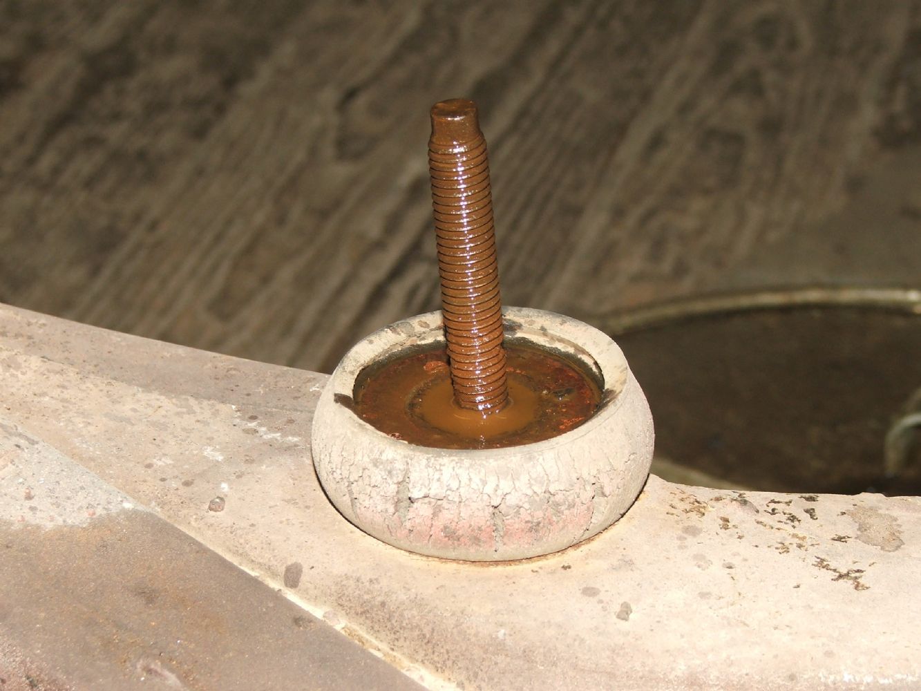

I have removed them off of my rancheros when I did my frame off. I used a large set of vise grips  grabbed the metal washer looking piece part of the bushing on the first car and I was able to remove it with little damage. The second car was a bit more work. I drilled two holes in the metal washer part and each side of the stud (12 and 6 o clock positions)and taped the hole for a # 10 thread. Then I screwed in some hardened screws and used the visegrips again to remove. I was glad I did too because the frame looked rust free but the rubber trapped water and the holes where enlarged from the rust.
Post Options Post Options   Thanks (0) Thanks(0)   Quote TV 2M8O Quote  Post ReplyReply Direct Link To This Post Posted: 18-February-2012 at 4:22PM

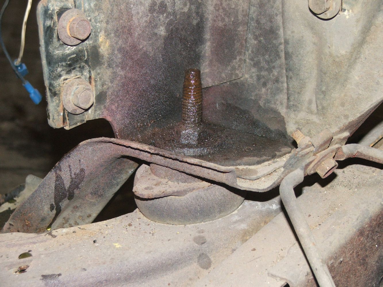

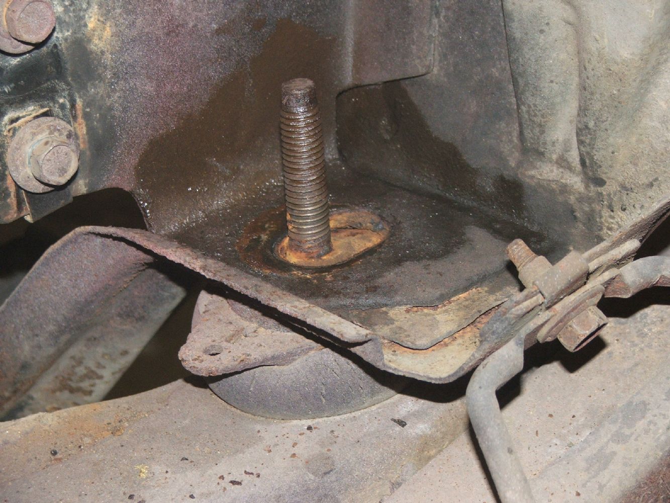

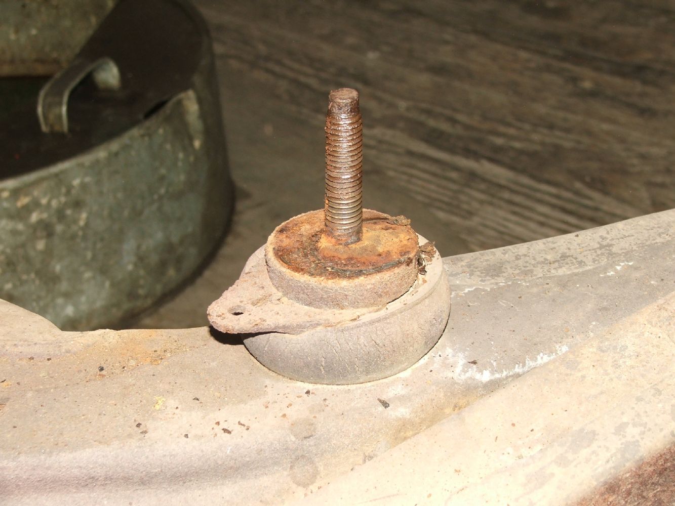

Carl,
There are only 2 rubber bushings on the core support of my car. Here is the disassembly progress....
Assembled height 1 1/4"....
On top of core support: thick washer and nut (note shim between support and upper bushing)....
Nut and washer removed....
Support removed, another thicker steel washer and shim....
shim....
hardware used.....
soaking upper bushing....
These parts are typical of both sides except driver side does not have the shim. My front has not be touched, so this was how she left the Chicago factory. Perhaps the earlier models had more rubber bushings??

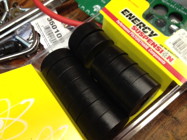

Post Options Post Options   Thanks (0) Thanks(0)   Quote GranTorinoSport Quote  Post ReplyReply Direct Link To This Post Posted: 25-November-2013 at 11:42AM
http://www.energysuspensionparts.com/proddetail.asp?prod=9.4102#
That is the one. I ordered the kit but have not used it yet. There is some discussion here about them. I think Eliteman76 originally but bushings on both sides of everything, which ended up being too much. I believe there is no bushing on the bottom of the frame (where the bolt head is), and then a bushing on top of frame (between frame and rad support), and then on top of rad support no bushing.

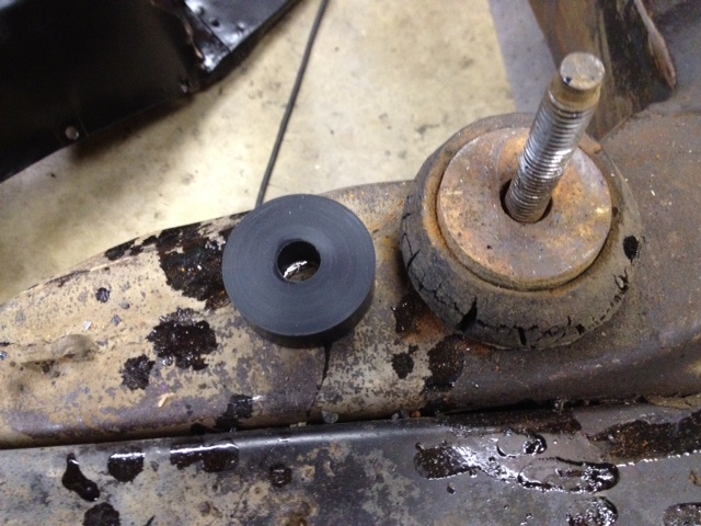

Ok, just went and checked on my 75 Sport.
Just as Malcolm and John have stated, there is a bushing on the bottom (below frame) and in between frame and core support. There is no bushing on top, just an extra thick washer and the locknut.
Here are some photos, and the new bushing is the energy suspension one for comparison.
