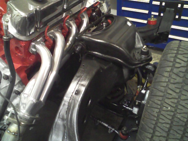

Here is what I did:
So here's an original core support with bushings.
I originally got core support busings for an 80's LTD from a local ford dealer that has NOS stock. These turned out to be the wrong material and too soft and they collapsed.
At this point my car is totally in the Joe Dirt stage and just barely under it's on running power...
Originally I bought a strut rod kit from Energy suspension for a 60's Nova 2 but while it fit fine, it was not right.
Enter the Energy suspension unreal mount kit:
Here is the universal mount kit vs. the smaller nova kit:
This universal kit is a bit larger but not to worry:
Keep in mind at this point I'm a moron and thinking I need to enlarge the opening on the rad support, but not the case. I had to clean up the frame holes on my frame.
Installed:

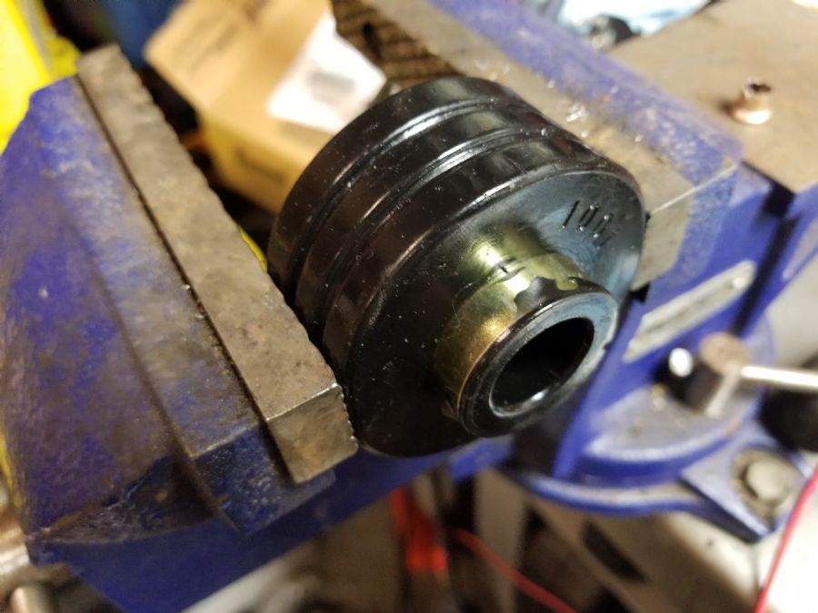

This may be too late for you Chuck, but hope it can help others.  I am just working on getting my rad support installed.  I had the same problem where the 1 1/4" sleeve doesn't fit through the frame hole. I didn't want to drill my frame, especially after fresh paint. So I figured the better option is to remove the sleeve.  Turns out most of the sleeve is just a thin metal ring.
I held the bushing in a vice and was able to pull it off with a pair of vice grips. I then cut the remaining poly protrusion off with a saw and trimmed with a utility knife to make it flush.
It now sites on the frame fine.  It's still a bit lower than my OEM setup, but I think I can shim it up with the shims from my factory bushing.
