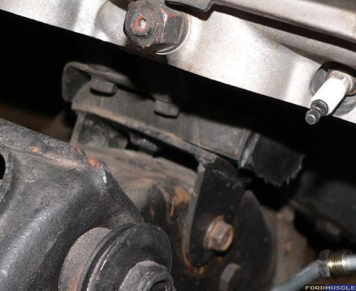

I've seen/played with the Crites ones, and made essentially the same thing out of fullsize car mounts.
Crites mounts don't sit quite the same as factory mounts, and may have fitment issues with headers made for factory mounts.
To make them yourself, get a set of fullsize mounts. cut off the "ears" that sit on the frame perches.
Now, look at your 385 block. You will see there is a lower area on the block between the bolt holes for the mount. Between those holes you drill a hole through the mounts. Now you need the part of the mount that saddles the torino frame. You can bend up/weld up a piece or use one out of a small-block mount. It needs a hole in it to attach to the mount. the bolt goes thru the mount from behind (Tack in place) and is (barely) long enough to assemble the Franken-mount.
For what it's worth, that is how the original Crites mounts looked like they were made. (Cut marks and all)
The factory 385 mounts have a block plate that goes on the engine, and a separate insulator that bolts to the block plate.

Post Options Post Options   Thanks (0) Thanks(0)   Quote Big Bird Quote  Post ReplyReply Direct Link To This Post Posted: 16-February-2016 at 9:24AM
These
at Dearborn look WORLDS better than the Crites mounts.
I'm thinking this is a new product, as I've never seen it before, or seen this brought up on here.
These look like a fairly good repro of the real parts. The Crites mounts, and Franken-mount conversions always made me uneasy with being held together by one small bolt.
I would research the Dearborn mounts if I were doing a big-block swap.  Looks a lot sturdier, and is probably a better option than hunting for a set of 40 year old salvage parts, or spending more on N.O.S. parts made of Unobtainium.

Post Options Post Options   Thanks (0) Thanks(0)   Quote Big Bird Quote  Post ReplyReply Direct Link To This Post Posted: 04-March-2016 at 1:27PM
Originally posted by zrusso91 zrusso91 wrote:
I ordered the mounts from dearborn classics website. I too believed they would be great because they appear to be OEM but do not be fooled. I just received them today and they were shipped from Crites and inside was a set of Crites mounts.....so disappointing. will be returning them.
Were they a 2-peice mount (bolts together on the ends) like the originals, or a fullsize car mount with the ears cut off and a frame bracket bolted thru the center????
zrusso91 View Drop Down
Joined: 19-August-2013
Location: mass
Points: 2
Post Options Post Options   Thanks (0) Thanks(0)   Quote zrusso91 Quote  Post ReplyReply Direct Link To This Post Posted: 06-March-2016 at 5:45AM
Frame bracket bolted thru the center,to the block plate/insulator. these mounts will drop your motor as far as it can be dropped in the chassis. my oil pan is nearly hitting the cross-member with these mounts installed. this i suppose is great if you run the crites headers and needed extra room up top for a highrise intake. but running hooker headers with these is a pain! manifolds should fit just fine. they really arent that bad but i happen to need some extra room for headers and these will not do. also if your still running the mechanical fan the shroud is going to have to be modified too.
Nuggets View Drop Down
Joined: 07-November-2014
Location: UK
Points: 869
Post Options Post Options   Thanks (0) Thanks(0)   Quote Nuggets Quote  Post ReplyReply Direct Link To This Post Posted: 06-March-2016 at 6:36AM
From the sounds of it you could fit a Weiand Stealth with room to spare using crites mounts then
