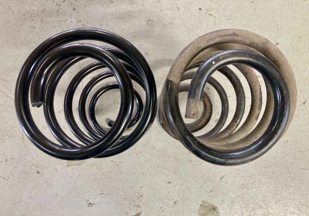

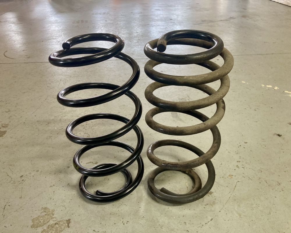

Post Options Post Options   Thanks (0) Thanks(0)   Quote Armkb Quote  Post ReplyReply Direct Link To This Post Posted: 21-March-2026 at 9:23AM
Found Lesjofors rear spring part#4427502 on Rockauto for $93.79 a pair. Has a wire diameter .620”, outside 7”, inner 5.25”, height of 15.24”. Pigtail is similar to the cargo coils I removed. Rate should be 150-170lbs.

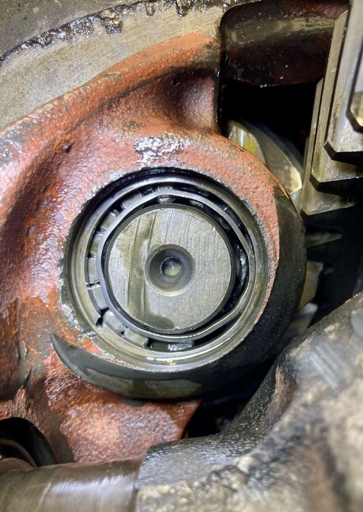

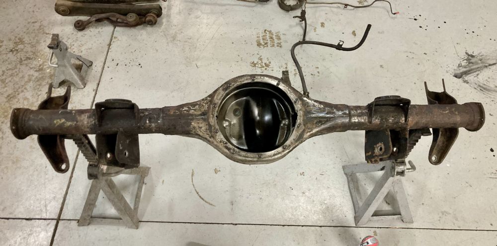

Replacing center diff. Pilot bearing on pinion was bad and ring gear had chipped tooth. Upgrading to a 31 spline diff and axles. Also adding Spohn upper and lower control arms, KYB shocks, PMT sway bar.
Post Options Post Options   Thanks (0) Thanks(0)   Quote 72 RS 351 Quote  Post ReplyReply Direct Link To This Post Posted: 22-March-2026 at 12:48AM
Very good, shame you had a bad pinion bearing, but that's a good plan to improve things.
