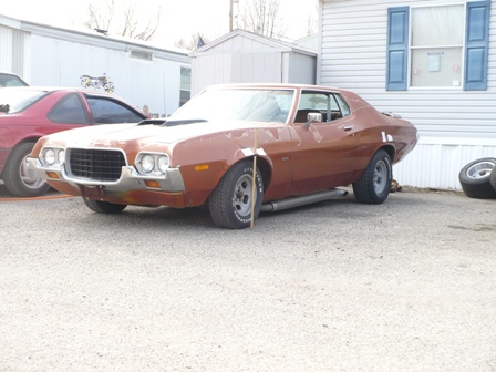

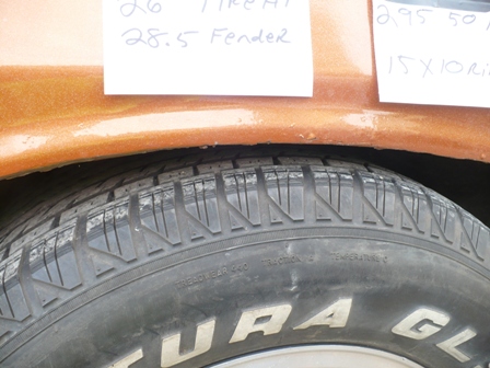

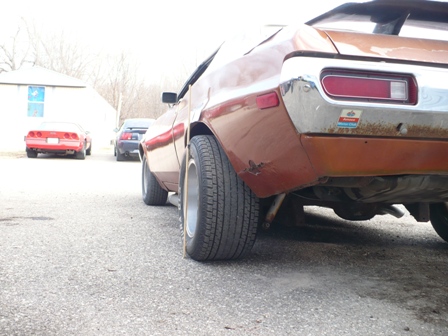

245/60-15 with 15x7 Magnums 4.25 back space on the front 295/50-15's on the rear w/15x8 magnums 4.5 backspace. thinking about swapping to 15x10 's for the rear same size tire . 1.5 " lowered in front with 2001 Crown Vic interceptor springs Ford #D9AZ-5310-W  . Rides & handles great!
Edited by Torinogts73c - 21-April-2009 at 2:53PM

295/50-15  is a good fit and easy to find as well!

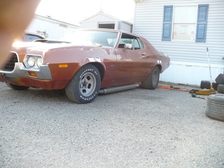

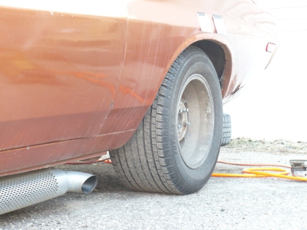

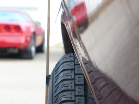

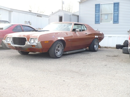

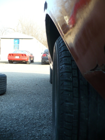

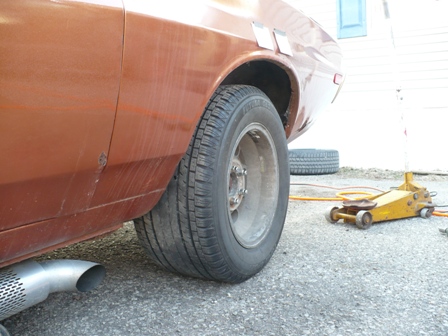

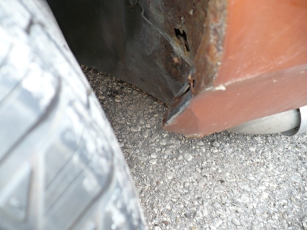

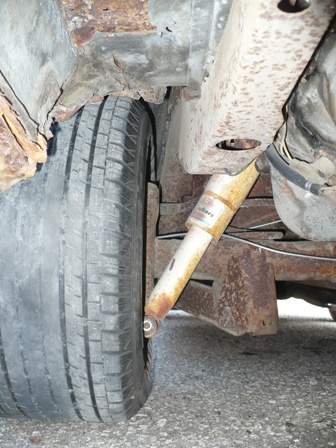

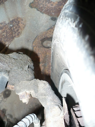

Post Options Post Options   Thanks (0) Thanks(0)   Quote Regul8r Quote  Post ReplyReply Direct Link To This Post Posted: 07-March-2010 at 5:03PM
Here you go...
Pumped air shocks all the way up!
275/60/15 rear on 15x7 rims, tire is 27.5" tall, fender sits at 29"
225/70/14 front on 14x7 rims, tire is 25.25"tall, fender sits at 26"
NOW... added the 295/50/15 tires on the 15x10 rims (3.5" backspacing)
Tire is 26" tall with fender sitting at 28.5"
You can see the tire sticks out and leaves alot of room to the frame.
NOW I dropped all the air out of the shocks to change the rake...
They RUB! Disregard the measurement card. The fender sits almost ON the tire!
Leave the 295/50/15(15x10rim) on the rear AND put the same on the FRONT!
Pumped the shocks back up for these.
With this combo it rubbed the front and rear of the front fender.
A small adjustment to the backspace would make it clear (MAYBE)
But damn it looks badass! NASCAR/MADMAX style like a bulldog that says DO NOT F**K WITH ME!
Here's the pics of the 295 on the front rubbing and rear clearance
Dropped the air pressure out of the shocks with the 295s on front and rear...
WOW THAT HAS A COOL FLAT STANCE!!!
Forgot that pic!!! Angry
Here's the PLAY with the rear wheel...
These are with the Airshocks pumped back up all the way.
Turned the rim around so instead of a 3.5" backspace it had 6.5"
With a 1/4" spacer it would bolt up without touching the rim cone to the drum.
With a 1" spacer it would clear everything at the frame and still be tucked inside the fender.
So I THINK a 4"-5" back space would put the tire and rim in the right place.
Clearance is TIGHT with the 6.5" backspace...
Wheel is tucked in...
Dropped all the air out of the shocks and it almost looks like it is tubbed...
So there are my Tire adventrues for the day!
MY decision...
295/50/15 on the back with a 15x10 rim have to decide on the backspace most likely 5" so it sits right inside the fender lip after I roll the lip under and smoothe the sharp edges.
255/60/15 OR 255/70/15 on the front with a 15x8 rim and then play with backspace to fit it in.
Have to put both under the fender and see what looks right, I am thinking the 255/60 is the right one!
Edited by cowboyupdjcarl - 07-March-2010 at 5:56PM
