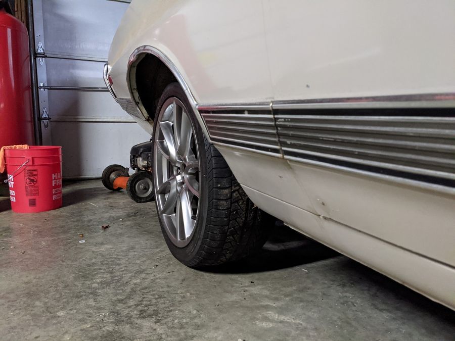

Post Options Post Options   Thanks (0) Thanks(0)   Quote rtgreen Quote  Post ReplyReply Direct Link To This Post Posted: 15-September-2021 at 5:01AM
Posting for reference,2012 Mustang 19" Performance Pack wheels on the back of the Torino. I'm using these wheels just to move my Torino around in the garage. There is about a 1/4 of clearance between the wheel and frame rail. This would not be a great choice for a daily.
72 Gran Torino Sport Q 4spd in Light Pewter Metallic
2012 Mustang GT (Brembo) 5.0, 6MT, 3.55s
1995 Bronco - 5.0 5spd.

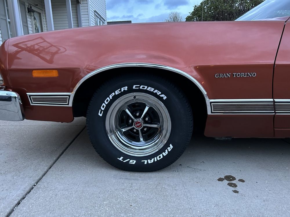

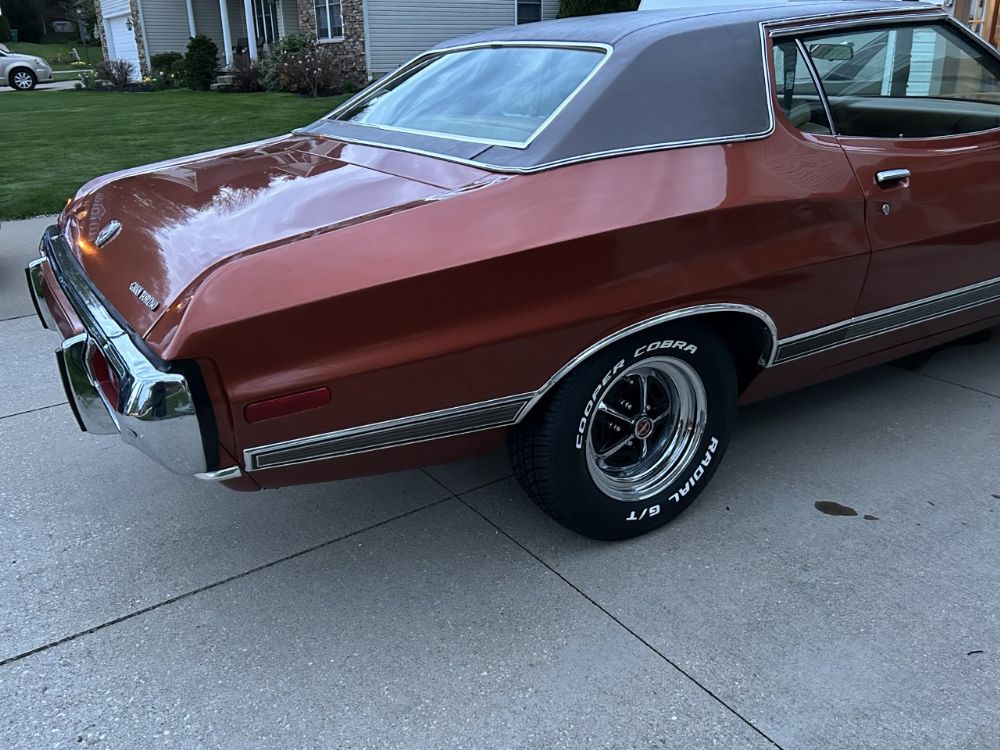

Post Options Post Options   Thanks (0) Thanks(0)   Quote spriegel Quote  Post ReplyReply Direct Link To This Post Posted: 29-April-2023 at 3:03AM
1973 Ford Gran Torino
P225-70R-15  (All)
Bolt pattern: 5 x 4.5
Rim Size:  15x7
Back-spacing:  4.25"
Brand:
a)  Rims:  Magnum 500 (Wheel Vintiques)
b)  Tires:  Cooper Cobra Radial G/T SL (Tire Rack)
-Chris
Fairview, PA
'1973 Ford Gran Torino
Post Options Post Options   Thanks (0) Thanks(0)   Quote hogfiddles Quote  Post ReplyReply Direct Link To This Post Posted: 29-April-2023 at 5:08AM
I like mags, or keystone classics, or torque thrust rims.
Those look great, Chris!
I’m not a fan of kidney bean rims.

Post Options Post Options   Thanks (0) Thanks(0)   Quote GregSmith Quote  Post ReplyReply Direct Link To This Post Posted: 31-May-2023 at 6:52AM
P225-70R-15  (All)
Rim Size:  15x7
Back-spacing:  4.25"
Brand:
-Chris
Looking good. I may copy what you did for my LTD. What are the center caps? Thanks!
spriegel View Drop Down
Joined: 28-September-2021
Location: Fairview, PA
Points: 992
Post Options Post Options   Thanks (1) Thanks(1)   Quote spriegel Quote  Post ReplyReply Direct Link To This Post Posted: 31-May-2023 at 11:09AM
Greg,
Thank you, I built a whole matrix of feedback from members on the forum, as well as put the Magnum 500's on with my Photo Shop software.
The center emblems are:
Supplier:  Kentucky Mustang
Item #:  14799
Description:  Wheel Cap Magnum 500 Ford Crest Metal Cap 2 1/8" Center 5/8" Tall
They have a separate web-site, but also list on their e-Bay store.  They are solid and good quality.
I've been very pleased with the rims/wheels/center emblem combination.
Thanks,
Fairview, PA

Apologies if this has been covered already however I cannot find it here.  1973 Gran Torino Sport.  Need direction on the widest matching tire size that will fit on all four corners for stock 14 inch Magnum 500 Rally wheels without rubbing.  Stock height, not lowered, not jacked, not cut. Need same for 15 inch Magnum Rally wheels (aftermarket) as well.  Thanks.  Steve in SD
Sioux Falls Steve
Post Options Post Options   Thanks (0) Thanks(0)   Quote Eliteman76 Quote  Post ReplyReply Direct Link To This Post Posted: 17-November-2024 at 11:14AM
Steve, best bet is to check Coker’s website. They reproduce a lot of the wide 14” tires. Realistically, guessing a 255 series tire but it’ll depend on the wheel width.
I forget the old tire classifications but I want to say a G60 or 60 series width.
Modern sizes would likely be a 255/60R14?
Post Options Post Options   Thanks (0) Thanks(0)   Quote Eliteman76 Quote  Post ReplyReply Direct Link To This Post Posted: 18-November-2024 at 2:38AM
As far as 15” wheels are concerned, usually a 15x8.5 wheel will be fine. 255/60R15 front and if you want a staggered look, 275-60R15 rear.
My personal preference is old school for 15” wheels, using a 15x9” wheel with 295/50R15’s.
I will tell you however 17” wheels with a 255/50R17 front and 275/50R17 rear works well as well, and still has plenty of sidewall to ride comfortable while still allowing you to have wider rubber to have fun with.
I’m running 18” wheels currently, 235/45/18 front, and 295/45r18 rear. I don’t care for the 235, too narrow for my liking but I’m going to run the tires until next spring up front.
If you want even all around, 255/60R15 are a good fit on all four corners.
Also, if dead set on magnum wheels, is suggest you consider the aluminum versions over the chrome steel.
Guys have had issues with a couple suppliers and runout and balancing of the steel reproduction magnum wheels is not that good so make sure before mounting and balancing the tires, check your wheels first to make sure no issues.
