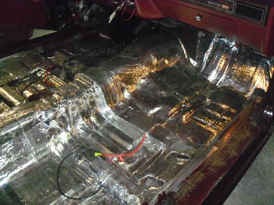

When I was working on mine(like that has stopped Embarrassed), I used a product from AudioTechnix, it was an 80mil sound deadener that used butyl as the adhesive(VERY aggressive) and an aluminum facing that is 7 mils thick. Most other sound deadeners at the time had facings of 2-3 mils of thickness and utilized an asphalt based adhesive. I used the 80mil deadener on the floor/firewall, doors, roof and even inside the subwoofer enclosure.
Try to stay away from the cheaper sound deadeners that use an asphalt based adhesive, unless of course you like the smell of a newly tarred roof, which is what you will encounter(especially on hot days) for weeks after it is installed.

I believe the company Audio Technix is no longer in business, sold out/bought by another company, not sure why the SD is no longer produced but it is/was a good product at a great price. That said, you can find 80 mil butyl adhesive backed SD from many manufacturers/suppliers, I found this product and it looks good at a good price:
It is good you are looking at installing a SD/heat insulator for your ride, it makes quite a bit of difference once applied correctly to "our" older vehicles that came with little to none of this from the factory. The original jute backed carpet does have some qualities for insulating and/or sound deadening, but nowhere near as effective as the latest offerings in SD/heat isolating technology.
