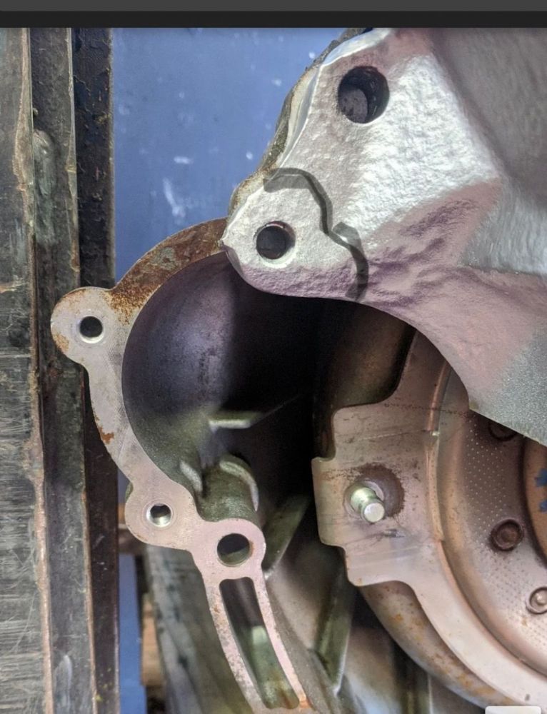

The modular engines all used a three bolt starter, all SBF's used the two bolt starter. The V6's came in both, the 3.8 and 4.2 are all supposed to be the two bolt starter, the 3.6 I think is the next V6 that had the three bolt starter. So it's very simple to look at the starter mounting, and count the holes.
Unrelated, but about the bell housing;
I discovered on Youtube long ago how people have adapted the later V8 modular transmissions to the SBF's. That's individuals doing it without the high dollar($700 to $1400) spacer kits. They were making a thicker separator plate of 1/4" or 3/8" steel, and welding onto it, two nuts to mount the starter. Plus cutting on the trans to make room for the starter, I got the idea; I'll use a 6R80 behind my SBF in my Explorer, by cutting off one block hole(bell housing threads), the one next to the starter. Doing that, the SBF will bolt onto any 4R70W or V8 6R80(different ones also came behind V6's and 4cylinders with a round bell housing pattern).
Here's the picture someone from Youtube sent me, which confirmed my idea. He and others space the trans back and use the SBF two bolt starter, but they have to also space the torque converter back. I didn't like the idea of small 1/2" spacers(or 1/4" or 3/8" either) on each TC stud/nut. So my thought was, do I really have to have all six bell housing bolts? I'll do without one, cut the block slightly, thread the dowel holes, and use just five bolts. Below you can see where the modular V8 starter location overlaps the SBF top bolt hole. With that cut off, then you can use the stock modular separator plate, three bolt starter, and the TC. Cast iron is hard to cut, and thread, so it will be tricky.

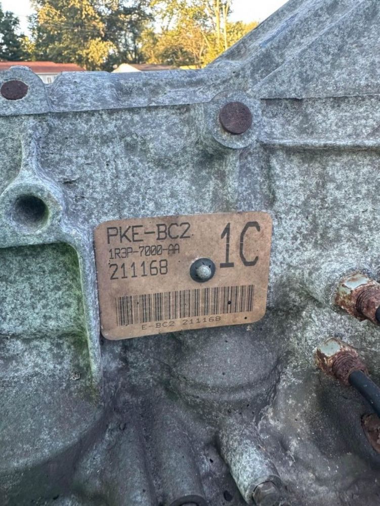

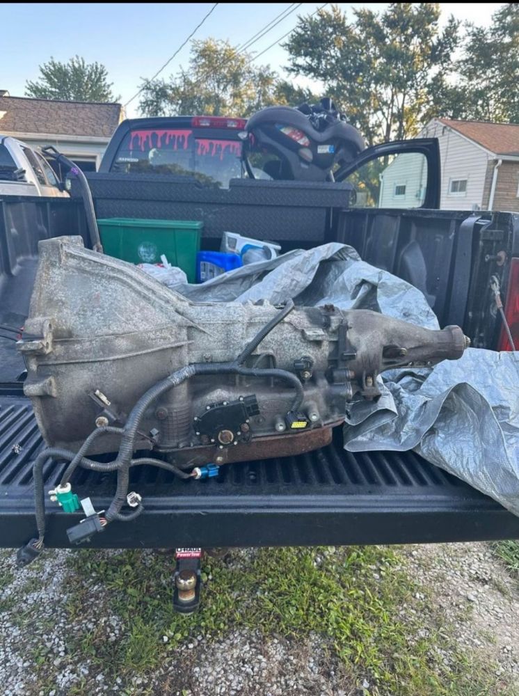

I picked up the transmission tonight. It's in very good shape, and the fluid is clean. The wiring harness is still attached as well. I have a lead on a 3.70 ring and pinion for $75 as well. I'll have to YouTube how to install them and set them up. I'll get the Quick 4 and figure out what else I need.
Thanks for all your help!
Post Options Post Options   Thanks (0) Thanks(0)   Quote 72 RS 351 Quote  Post ReplyReply Direct Link To This Post Posted: 17-October-2023 at 6:46AM
Very good. I'm sure you will love the end result, the hard parts will be working out the shifter cable and bracket, driveshaft, and the wiring of the Quick Shift 4.
