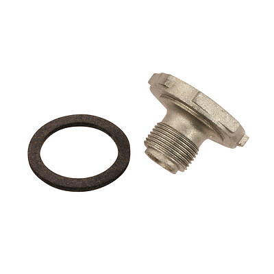

IIRC, the Motorcraft 2150 carb uses the same type of power valve that a Holley uses, if so you may want to try a power valve plug that is usually used on the secondary side of a Holley 4150 to verify if it is in deed a diaphragm issue or a cracked carb body issue. This is the Holley PV plug I am referring to. Hope this helps. Quick Fuel 25-1QFT Power Valve Plug | eBay
 Quick Fuel 25-1QFT Power Valve Plug - Picture 1 of 1
