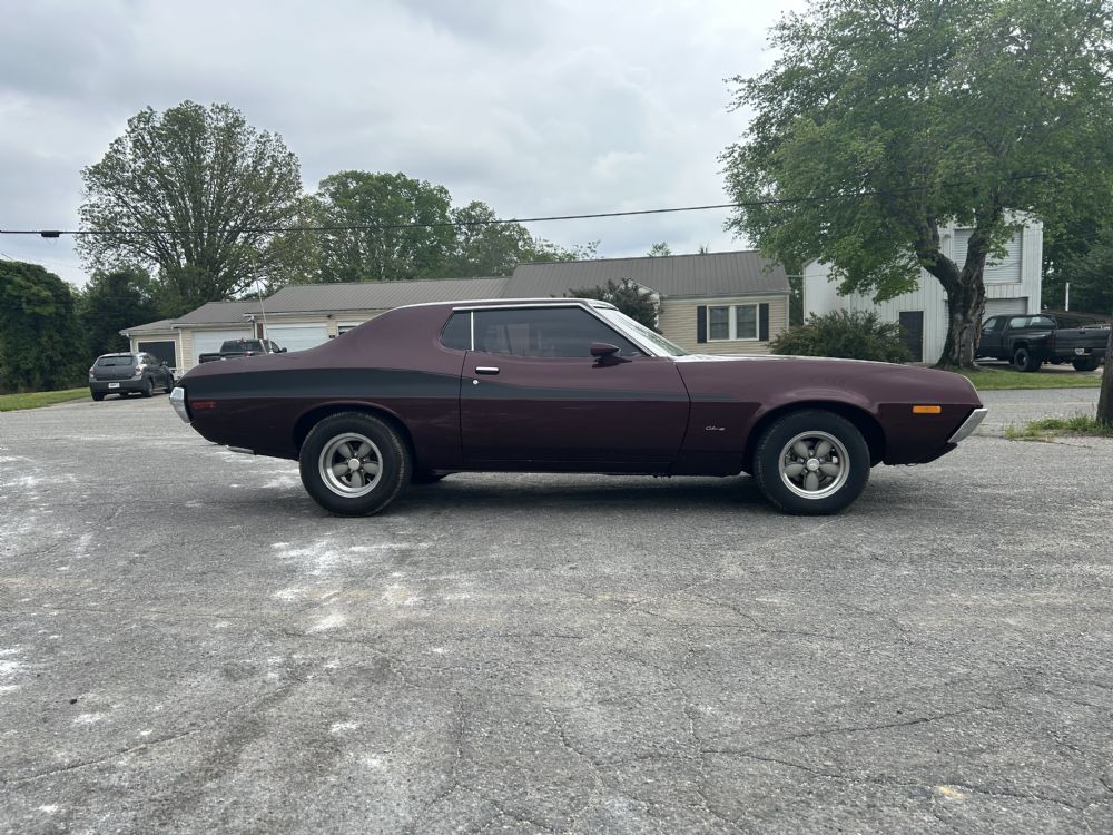

Post Options Post Options   Thanks (0) Thanks(0)   Quote n2fordwagons Quote  Post ReplyReply Direct Link To This Post Posted: 12-May-2025 at 6:45AM
Here’s the final result.
I used new Lesjofors 4127521 springs on the front, cutting a coil.
On the rear I used a pair of springs from my 73 Torino sedan parts car.
Jeff
72 base Torino (modified)
72 Gran Torino Squire
Post Options Post Options   Thanks (0) Thanks(0)   Quote 72 RS 351 Quote  Post ReplyReply Direct Link To This Post Posted: 12-May-2025 at 1:50PM
That's a great stance, the height and tires fit really well. Thanks for the pictures.
Post Options Post Options   Thanks (0) Thanks(0)   Quote 72FordGTS Quote  Post ReplyReply Direct Link To This Post Posted: 14-May-2025 at 8:35AM
The stance looks awesome.  What is the application listing for those coils?  Any specs on them?
