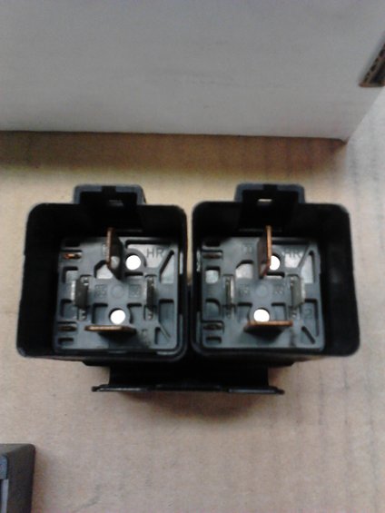

 Here are the pieces I used for my dual fan install:
The Derale adjustable fan controllers aren't rated for anything higher than 25amp continuous, but they are adjustable and can be operated by either the supplied screw-in sensor or can be wired to the A/C compressor's 12v clutch engagement source or this same wire can be used as a manual override to bypass the temp sensor all together(basically a failsafe).

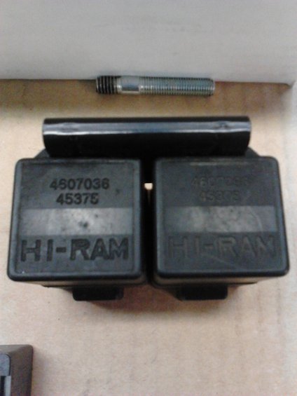

I picked these 70amp relays w/mounting tabs out of a Chrysler product while on a junkyard trip, at a $1 each, they were hard to pass up.
The 70amp relays have much larger terminals for the battery and load connections and are copper plated. I used the negative trigger from the Derale units to ground the "signal" side of the relay. Basically these larger relays operate/wire up exactly like a spst Bosch relay.
 #85 would receive the (-) trigger from the Derale unit. #86 would receive 12v when ignition is on. #30 goes to high amperage 12v fuse(I used a 100amp fuse, overkill I know, but absolutely no problems so far) and #87 goes to positive side of electric fan motor.

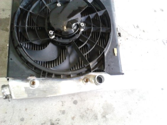

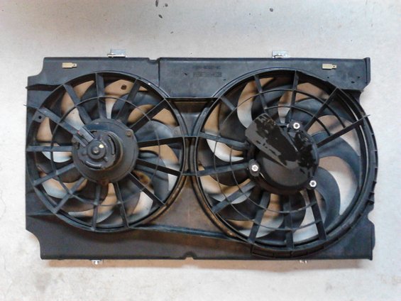

This is a dual electric fan assembly out of a '96 Ford Windstar, even though it has two fans it fits my big block powered Ranchero much better than the Mark VIII single fan(wouldn't fit without major mods to core support).
The "shroud" required minor trimming(inlet/outlet rad hoses and trans cooler lines) and a couple of tabs fabbed up/attached to the bottom of the assembly to locate them in the core support. The larger Windstar fan motor was replaced with a Mark VIII two speed fan and wired to operate in high speed only. My Ranchero runs on the larger fan 80% of the time, the only time the smaller 2nd fan runs is during the summer or in heavy traffic.
Sorry for the long reply, hopefully it will help. Todd

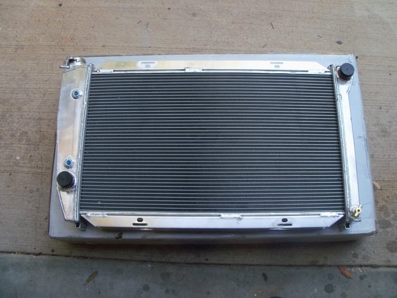

Andrew,

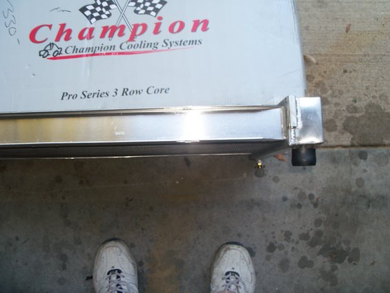

 I went with an all aluminum 3 core rad made by Champion, may not be the best out there but hasn't given me any issues and the price was right.
I have to tell you, it was an "eye-opening" experience the first time I went to WOT after removing the heavy fan clutch/clutch fan assembly from my BB. Hope the pics help. Todd
Points: 4938
Post Options Post Options   Thanks (0) Thanks(0)   Quote Eliteman76 Quote  Post ReplyReply Direct Link To This Post Posted: 20-January-2015 at 4:33PM

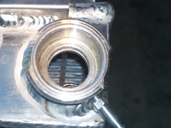

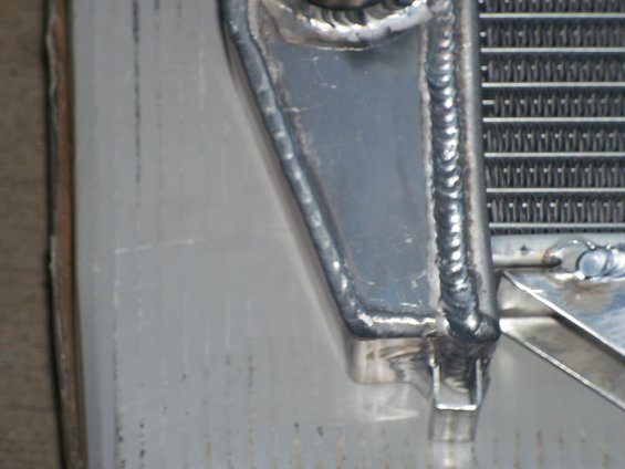

Hey, the tigwelds on that look pretty decent.
I appreciate the info.

There are several OEM Ford fans that can be great to cool V8's in a swap application. The Mark VIII and the biggest Taurus fan are the most well known. The Taurus fan is virtually the same motor, but it has a 1" smaller fan and it's little thinner. The late Crown Vic fans are supposed to be about as strong, but I've hardly ever seen one in a completed swap project. I've read of the Aerostar fans, but had never seen one. That might be a great choice for thin spaces.
I've got a used Mark VIII and Taurus fan from trying to use them for my Mountaineer. They were too thick for that(3.5" max space). I'll see how they fit(and look) in my Ranchero with a SBF.

Ok... I did a Mark VIII.
I used two golf cart solenoids, one for low speed, one for high, an autozone adjustable tstat, two small relays, and a bypass switch.

Update: I did some testing today on 3 different Mark VIII fan assemblies/motors I pulled at a local U-Pull-It and had sitting on my warehouse shelves. I used a Southwire 22070T AC/DC current clamp meter.  Fan 1) Spiked 84.4 amps at start-up and 31.6 amps running. Fan 2) 71.3 amps at start-up and 27.7 amps running.  This last one is installed in place of the larger fan motor in my Windstar dual fan assembly installed in my Ranchero, Fan 3) 69.7 amps at start-up and 25.2 amps running. These readings are with the fan wired for high speed operation. I figured the #1 fan may be on it's last legs due to the increased amperage readings. With both Windstar fans running, both large and small, the running amperage is 42.7 amps. Testing shows that there is a certain amperage "range" between different motors of the same design/size. I hope this info helps someone looking to install a Mark VIII fan. Todd

Todd, that is incredible information, and very good to know. That is a huge startup current for those, but the running power draw is not too bad, as I think my Flex-a-Lite dual fan setup draws more than 27 (it is more like your 42 amp Windstar setup). It would be interesting to measure the startup and steady state current on mine, but I do not have an amp clamp (had considered getting one someday).
Paul - I remember you talking about the golf cart solenoids - and I think that is a great idea. Aren't those meant to be actuated in constant use, so they'd be fine with the rigors of under hood use.

The radiator is the most important item, plus the air volume which reaches it. I have the typical 95-01 Explorer SUV's, and their radiator is so efficient that the fan is not needed much at all at low speeds or stopped. My 99 with the electric fan was very quiet, the fan I'd bet never had to run half speed. It would start really slowly, and barely be audible in stop and go traffic(I delivered mail with it for 70k+ miles).
I bet with a high quality aluminum radiator and a strong fan, less than 15 amps would be needed in stop and go traffic.

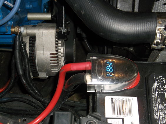

  I have already "stepped-up" to a 130amp 3G, one of the best upgrades I have done. While the fan is engaged/running, my positive battery terminal's voltage gauge reads 14.4v(this pic shows when the there is only the Crane ignition and Edelbrock electric fuel pump on with engine running).

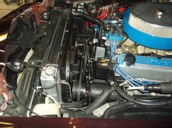

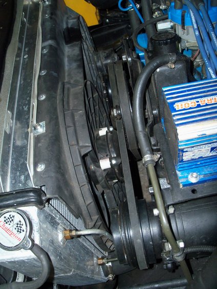

 Here is a couple pics of the Windstar assembly in my ride:
Points: 2653
Post Options Post Options   Thanks (0) Thanks(0)   Quote 72 RS 351 Quote  Post ReplyReply Direct Link To This Post Posted: 25-January-2015 at 7:19AM
I like the looks of that Windstar fan, it's great to know that there are good OEM choices out there.
