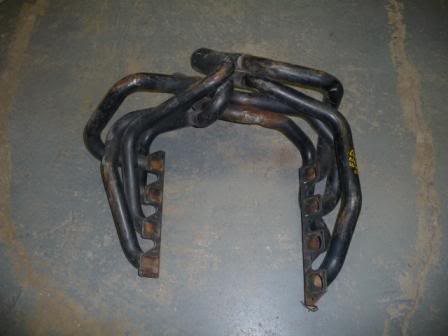

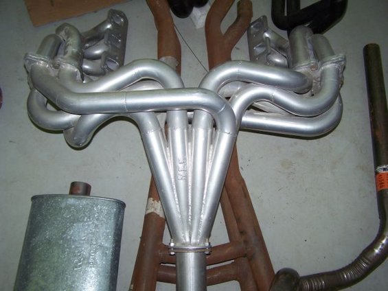

180* system for a DeTomaso Pantera
180* system for a 351C dirt track car
180* system for an FE engine

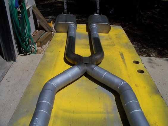

and a pic i gleaked from aquartlow in the thread where i posted the article

Wow! Super cool piece. My exhaust has the h crossover. The x crossover sounds great though. My car is running a 351c 4v with straight through thrush on and it drones like hell

Rockatansky,
  Man, I forgot just how unattractive my flux-core welded(no shielding gas at the time) exhaust system looked, glad it's on the underside Embarrassed. All double welded, works good, no leaks and has that "F-1" evil-ish exhaust note when going WOT. I modified a PYPES XVF13 kit to fit my application.
