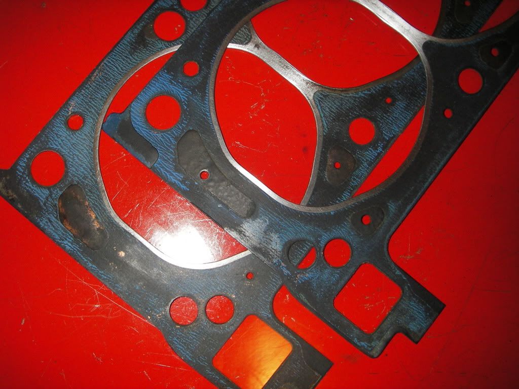

i prefer the fel pro perma-torque blue like in the above pic! i've used victor gaskets on some engines they are ok but not as good as the fel pro. yes check the surface for flatness! yes any more than .003 should be resurfaced! (and not with a belt sander type machine Thumbs Down
Yes for Perma-Torque blue!
