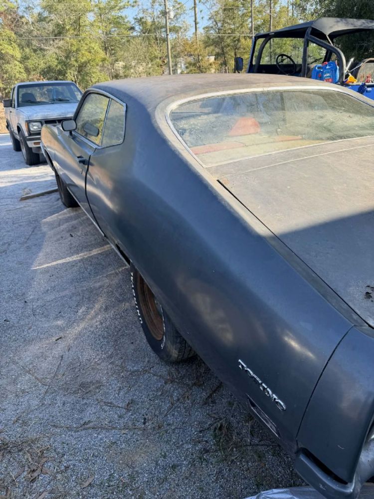

Hello all, I have been posting in the ranchero forum for some time now. I owned a 71 ranchero GT for a little while. I posted on a Facebook group that I was looking to trade my ranchero for a 71 Torino GT. Surprisingly, I had someone relatively close to where I live reach out to me wanting to trade. So, I picked up a 71 Torino GT. 351C with a C4. I have always wanted a 70/71 Torino Fastback, it has been my dream car for as long as I remember.
 I do have a few questions for yall:

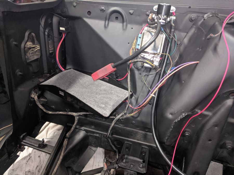

The previous owner fixed up the area around the battery tray, but there is no actual battery tray in the car.
I found this replacement from auto krafters, https://autokrafters.com/battery-tray-1970-ford-fairlane-1970-71-torino-cyclone-montego-1971-73-mustang-cougar-black-d0oz-10732b/ , has anyone used this one or any similar? Hows the quality?

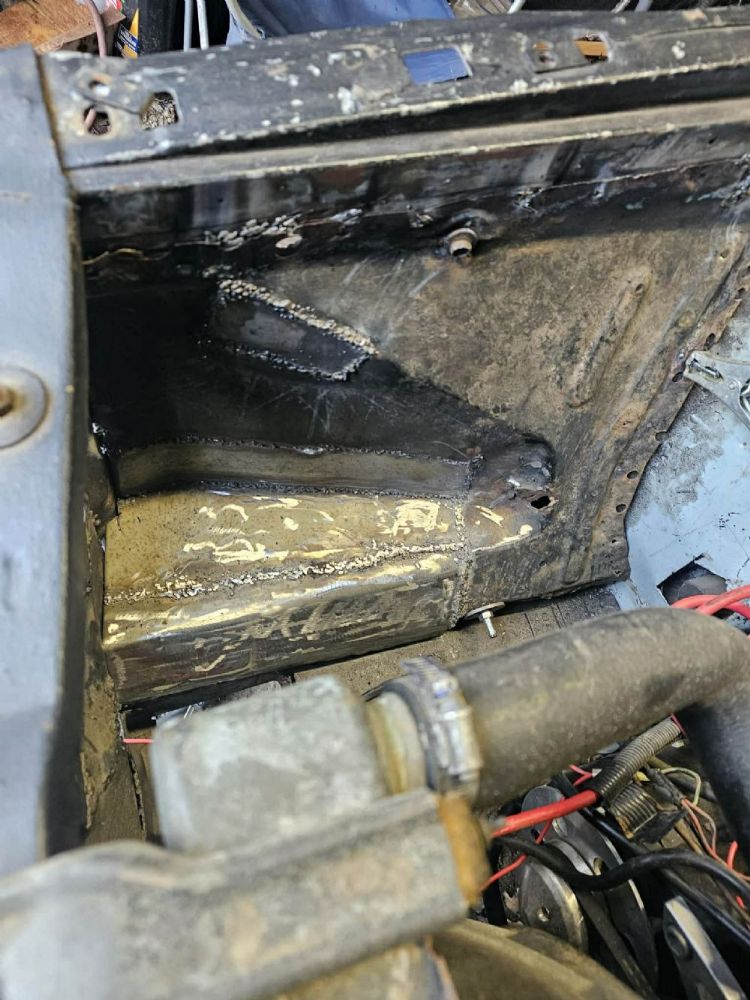

He replaced the passenger torque box, but the driver side needs to be replaced. Anyone have a link to a replacement torque box?

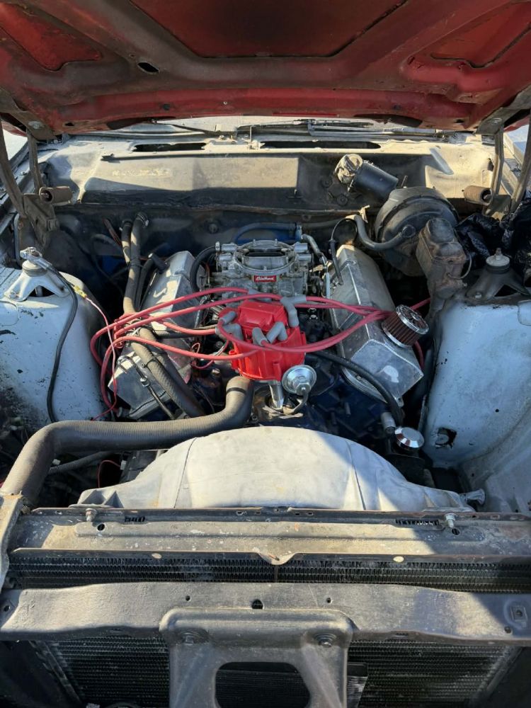

Previous owner claims the intake and the heads are cobra jet. The vin does match a 2v Cleveland, and now there's a 4v intake and heads on it. How can I verify if the heads and intake are cobra jet? Is there any noticeable difference with cobra jet and a stock 4v?
I'm sure I will have more questions as time goes on, I am really excited to get to work on this car!

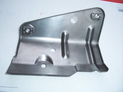

As far as the battery tray, I used that one and it works well. I will say that I also replaced the entire apron with the 71-73 Mustang part, so it was intended to go together. But I believe there was no difference in the bolt locations between Torino and Mustang for this year.
There's also a support plate underneath that is currently only reproduced by an individual named Dan, I bought one 3-4 years ago for $30: postaldan at msn.com.
so H code vin? could've also been a 351W-2V so you may want to investigate the block as well, casting & date codes are near the starter.
here's the low-down on the various 4V Cleveland engines offered over the span of production
the easiest, most accurate way IMO to determine what heads you have is by the date code found on an intake runner in the valve spring area. along with this chart compiled by members of the Cleveland's Forever forum. click on this link then click on the pdf to open the 351C 4V Cylinder Head Repository
https://www.tapatalk.com/groups/351c/cylinder-head-repository-home-of-the-dot-no-dot-t4793.html
there'll also be a casting date code on the intake but if it's a square bore carb flange it's M code, spreadbore it conforms to Q code / Cobra-Jet. there are issues with both types, the square bore manifold has small throttle bores and will not accept a big carb. the spreadbore manifold only accepts a 4300-D carb or requires a specific Trans-Dapt 2199 adapter plate. i wouldn't sweat the Cobra-Jet thing, some people get way to worked up about it. FWIW the factory CJ is a low compression smog dog, but it can be woken up!

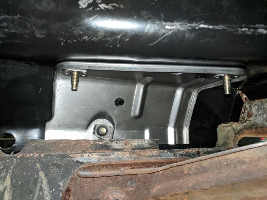

Thanks a lot, do you mind sharing a picture of how the battery tray attaches to that support piece, and where it attaches at by the wheel well?

Sure. This picture is from the wheel well perspective. The support piece goes underneath the apron and the tray bolts (2) will thread in from the top and one will thread in from the side bracket. Based on the repair on yours, it looks like you'll need to re drill the holes in the apron.
After bolting the tray in place, I had a friend put a few spot welds for extra support.
Dan

Thanks a lot, I got the battery tray installed no problem.

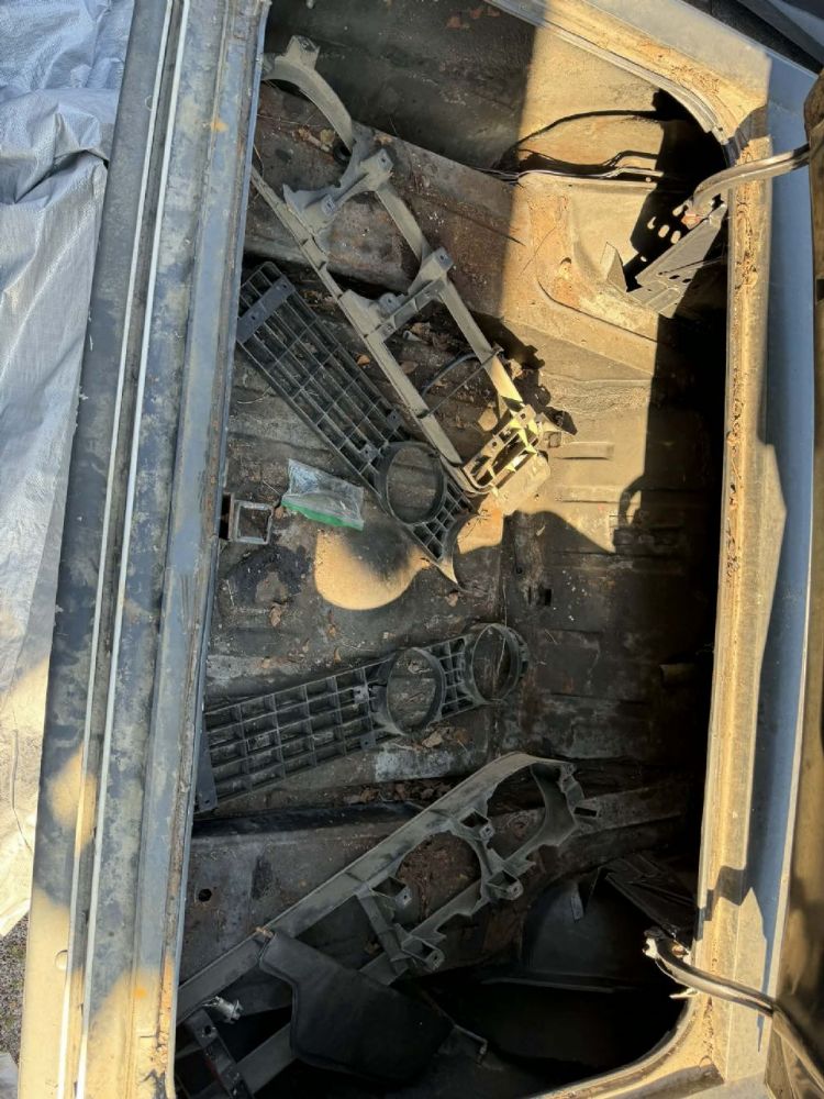

Anyone have a video, or a resource on re attaching the grille? It was taken apart when I picked the car up, everything is there, I would just like some type of resource on properly putting it back together. I'm a "Do the job correctly the first time" type of guy so anything helps.
