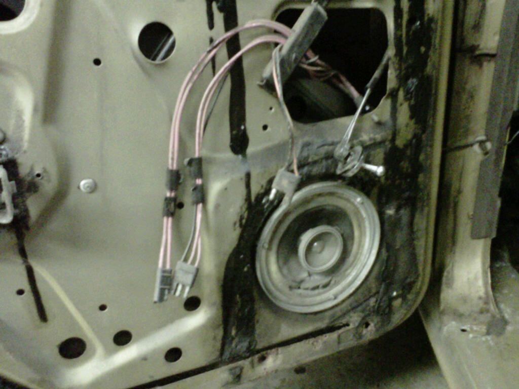

Well I am having to continue sticking to the inexpensive stuff.  I had a flat on my pickup this week and after plugging it and deciding to break the news to my wife (financial advisorWink) that by the end of the summer or early fall, I will have to invest in some new rubber.  So........that shuts down my plans for the GTS till then.  I pulled the door panels off, some interior trim, and gonna try to save the headliner and see if she can stitch it back together.
