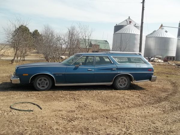

Had 2 Google images side by side and came up with this:
Windshield/windshield trim/seal
Marker Lights
Door handles
Quarter panel trim on 72-73
Dash
Steering components
wiper components
72-73 rear valances
72 front valances
Dome light
I would think that the Ranchero/Wagon bumpers are interchangeable.
My wagon's fuel door is located on the left quarter panel. No reserve tank.
Edited by GTW - 31-May-2012 at 12:14PM
