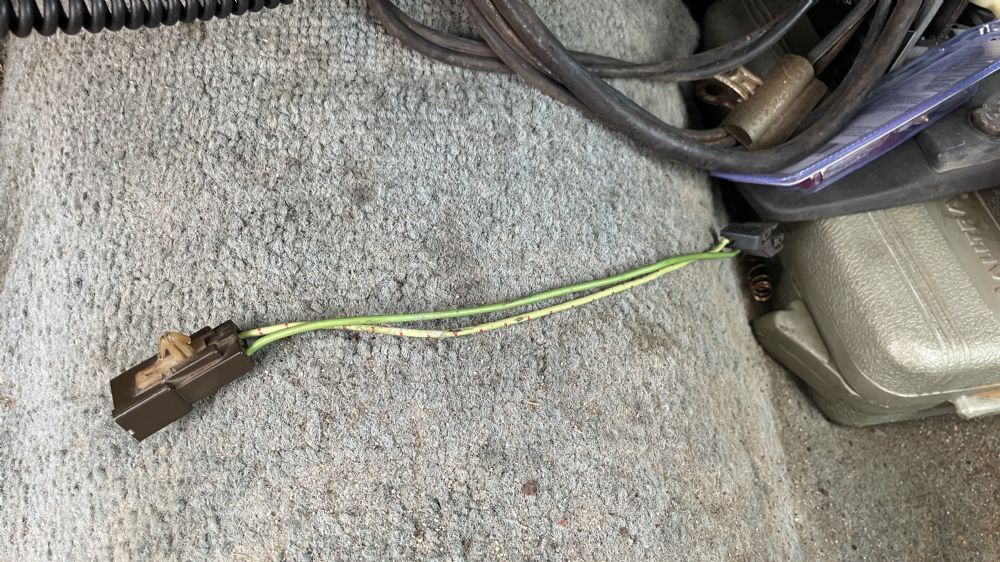

1973 wagon. I had my power brake booster refurbished a while ago. The brake lights worked before I had the booster refurbished, but I put my brake light switch back in and don't have brake lights (I do have tail lights. The rear turn signals have always worked, the hazards worked before but not anymore, and I have a grounding issue with my front turn signals that I haven't sorted yet (I just have the three wires on both taped off with no connector or bulb right now). The brake lights work when using a power probe.
I already had the instrument cluster out because I just cleaned out my fuel tank and had to do some soldering to make the fuel gauge work again. I unplugged this wire from behind the instrument cluster, which goes to the brake light switch:
I only have 9.5 volts at this connector where that other wire I unplugged goes:

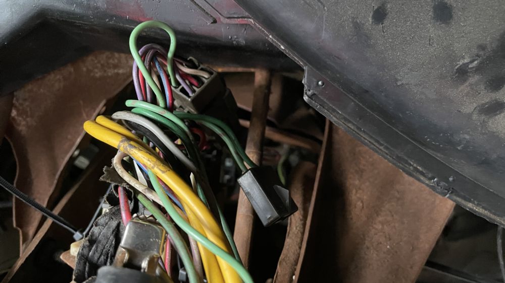

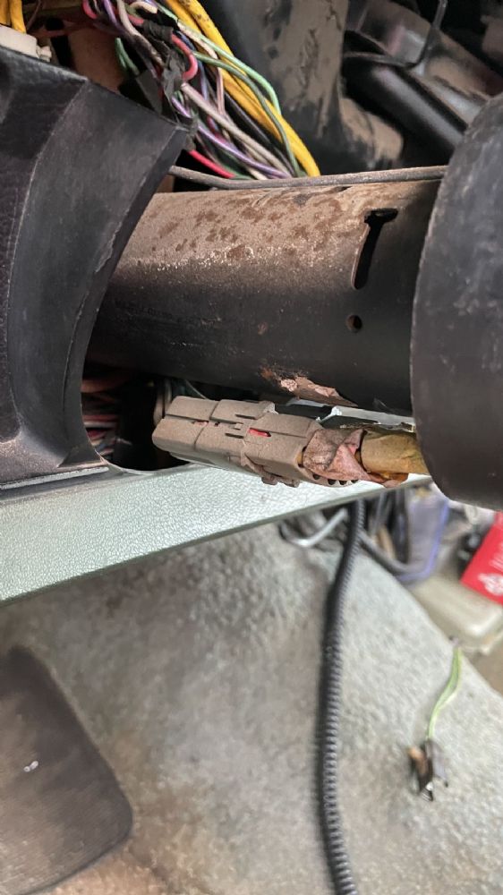

I've been pouring over the service manual, wiring diagram, and previous posts here...and from what I've found, the green and pink wire goes to the turn signal switch, which should be this connector here, I think?
I'm also unsure of exactly what this connector is for, by the brake light switch:
After that point, I'm lost. Could it be a problem with the wiring in the turn signal switch connector? Do I just need a new turn signal switch and/or flashers? I just know I have to have brake lights if I'm gonna drive on the road...

I’m still wondering if I actually reached the turn signal switch though…and about what to do if the fuse/fusebox isn’t the problem.

While you are at the fuse box, have you measured the voltage from the fuse box?  I would do that and then follow the circuit and check the voltage at various points to see where the voltage is being lost.  I would also double check all your grounds in the circuit, remove them and clean.  It might be worthwhile to look at the brake light switch itself.  I have a had a few go bad over the years, but usually you just get no brake lights when it fails.
