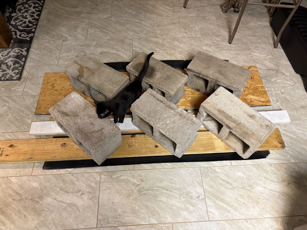

Trying to get it flattened out. I dampened the backside, and I'll let it sit like this for a couple of days. Fingers crossed.

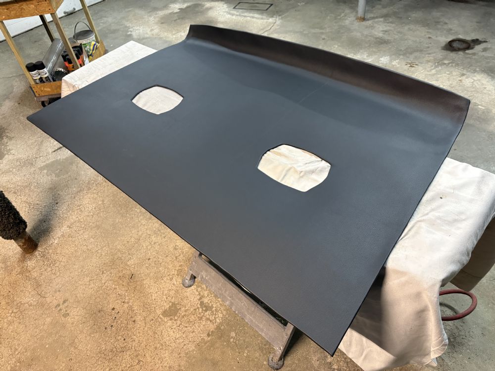

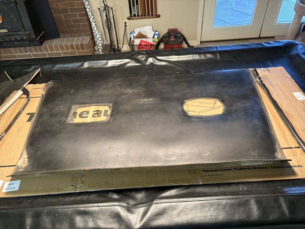

All done. Not perfect, but not too shabby. Definitely good enough for who it's for. First picture is some of the fiberglass repair I did on the backside and around the edges. I tried to minimize the work on the top so it would be as smooth as possible.

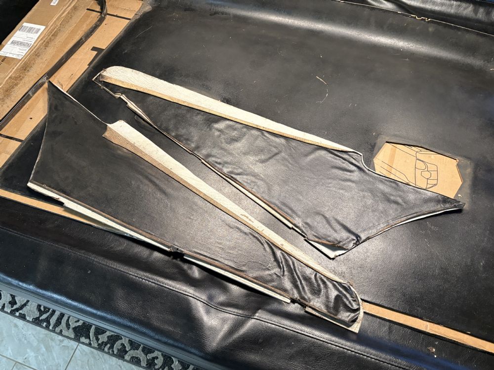

![]() Sanded the edges and smoothed the top as needed and then covered it with 1/8" EVA foam. Unfortunately, I didn't take a picture of that. I followed the foam up with marine vinyl I got off Amazon. The vinyl came folded instead of on a roll, so I have some creases that show a little. Not bad, and maybe they'll disappear or minimize over time. There are also some waves in the board, but 100% better than before. ![]() Now on to the sail panels. That should be a little simpler.
