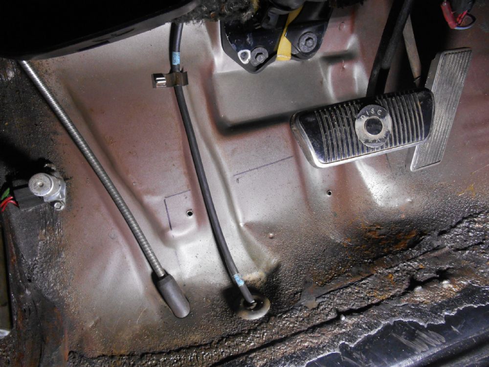

I had my interior apart a few years ago, these may help.  Here's the brake cable & speedo cable exit points.  There's a plate that covers the speedo cable that's removed in the pic below.  I had drawn a rough outline of the edges on the floor.

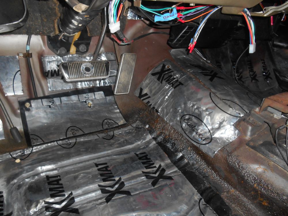

Here is with the plate installed

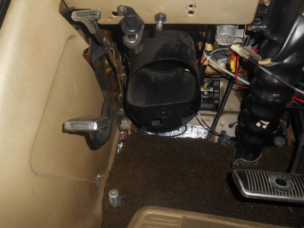

Note the brake cable leaving pedal assy. near top corner of carpet.
